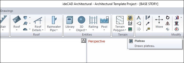

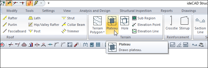

Plateau Command Location
You can access it under the ribbon menu Home tab Terrain title.
In Structural Program
  • Click the Plateau icon in the ribbon menu .

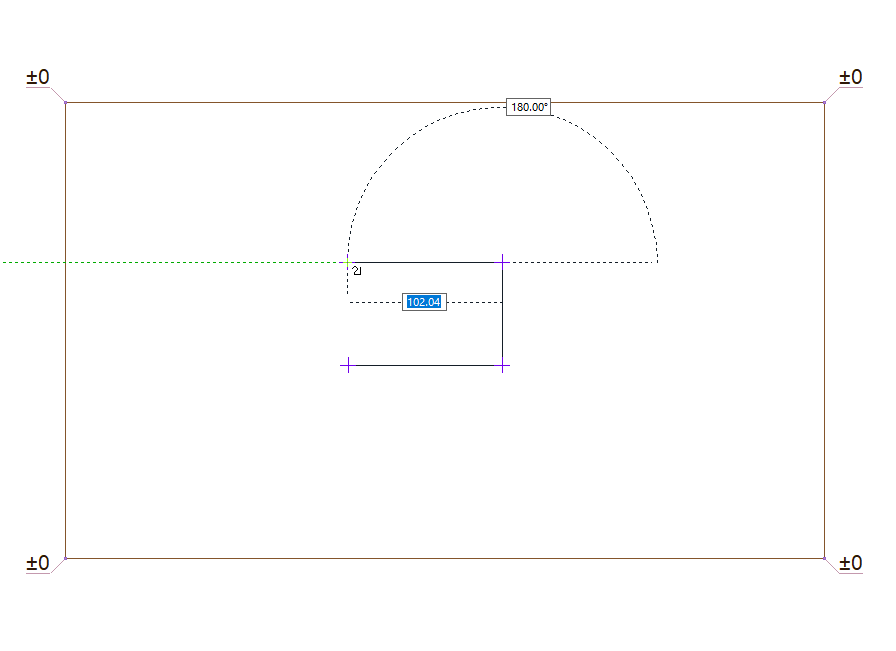

  • In addition , a toolbar named Path Segments will appear next to the terrain toolbar on the screen .
  • The Path Segments toolbar contains icons for drawing straight, circular and curved contours. When defining the plateau, these icons are used according to the need.

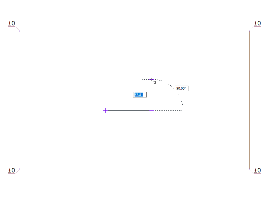

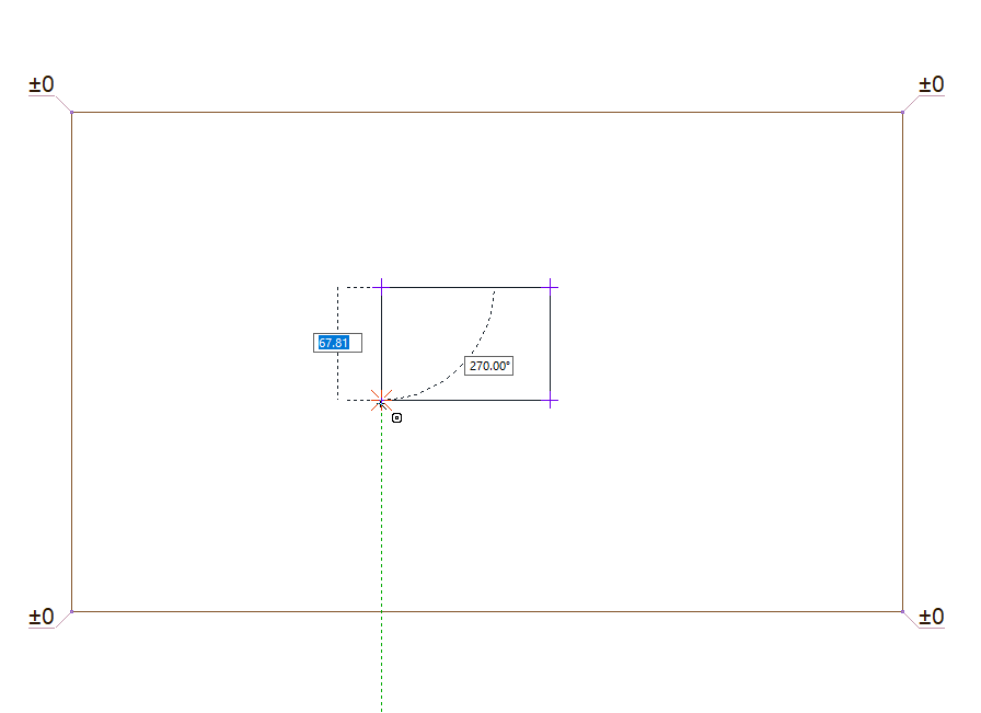

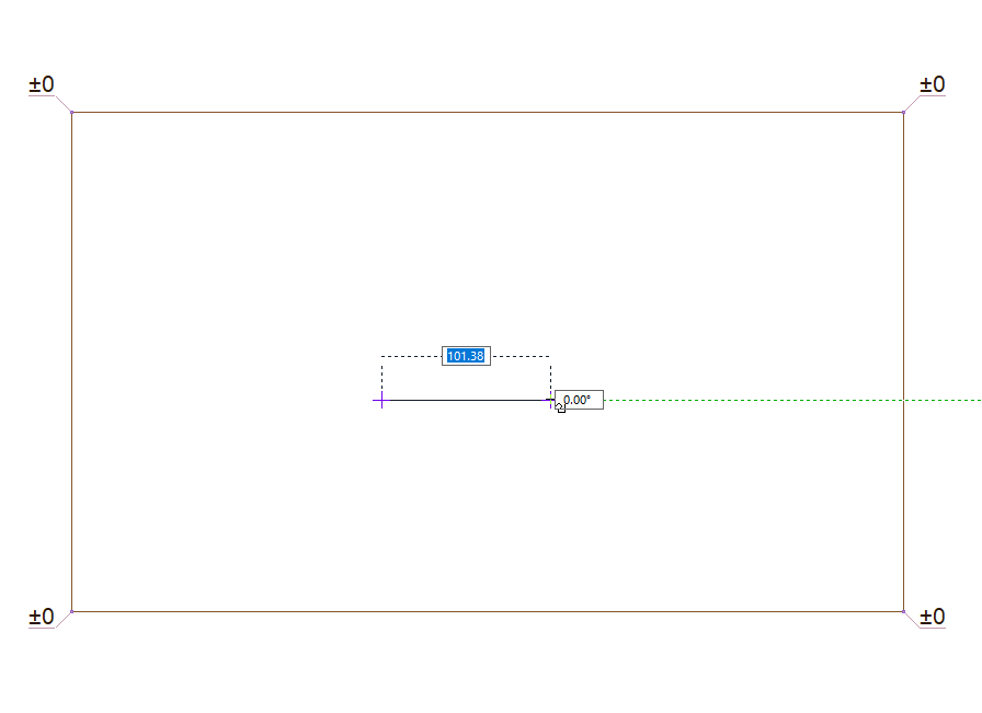

  • Move the mouse over the terrain you defined earlier.
  • Click the corners of the plateau on the drawing screen, respectively. Write the elevation of the point you clicked in the elevation box on the toolbar at the moment of clicking.

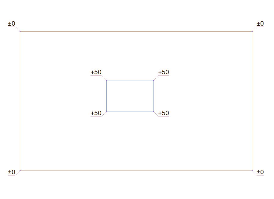

  • When you define the contour of the plateau and reach the point where you started, the process will be completed.

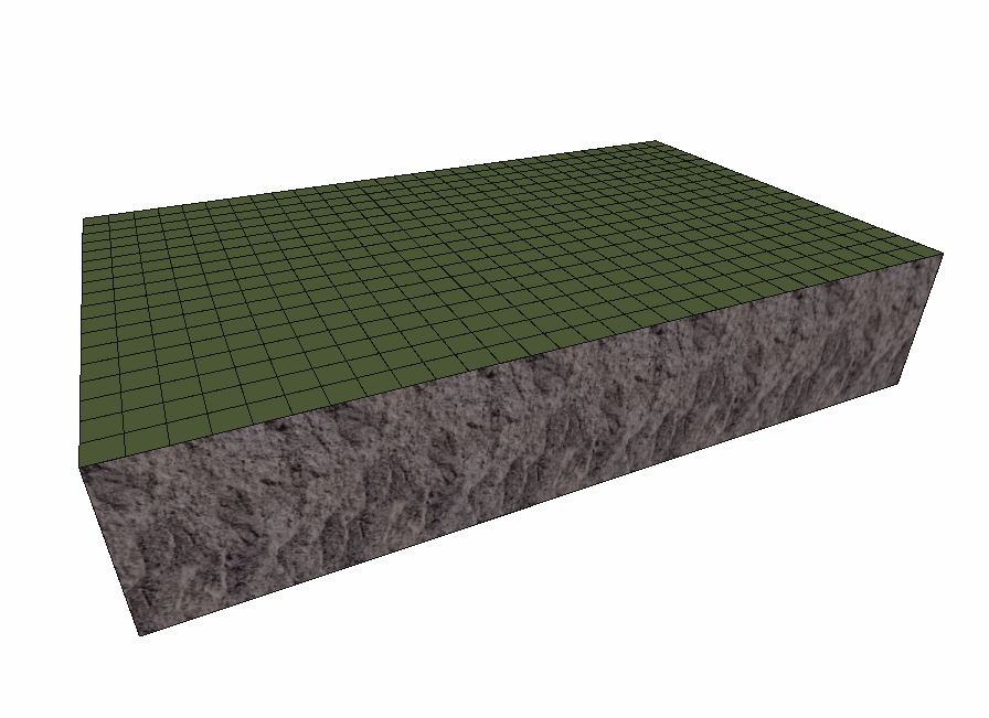

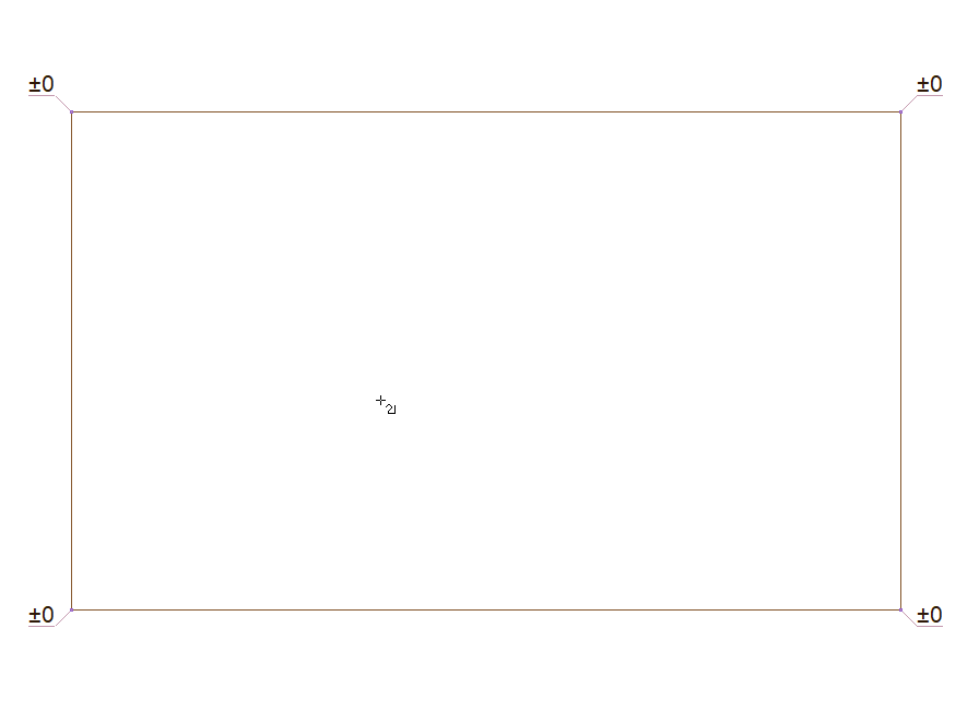

Terrain before the plateau is created
Entering the elevation value (50 cm) into the terrain toolbar opened while in the Plateau command
Determining the first point of the closed polygon to be created for the plateau
Plateau formation
Terrain after the plateau has been created

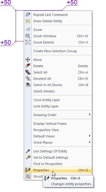

Location of the Plateau Settings Dialog Location
Select the plateau you want to enter its settings, click the right button of the mouse and click the Properties line from the menu that opens .

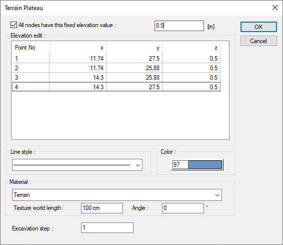

Plateau Settings

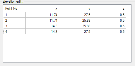

Elevation edit
The coordinates of the elevation points placed are given. If wanted, a new value can be entered into the z box.
All nodes have this fixed elevation value
The feature is activated and the value entered here is applied to all elevation points.
It is the drawing color of the plateau line in the plan. When the color box is clicked, the appropriate color is selected from the window that opens.
Line style
The line type of the plateau line in the plan is selected. Clicking the down arrow buttons to the right of the boxes opens the list of line style. From this list, the wanted line type is selected by clicking with the left mouse button.
You can select the material of the plateau surface by clicking it from the list.
Texture world length
Angle
The angle of the texture is given. With the angle value, you can adjust the angle of the texture according to the direction of its plane.
Excavation step
Terrain and pieces of terrain are given counts for excavation calculations. The excavations of the terrain and terrain plots with the same number are calculated and shown as total value at once, and the excavation of the terrain or terrain plots that are numbered separately as a separate item.
