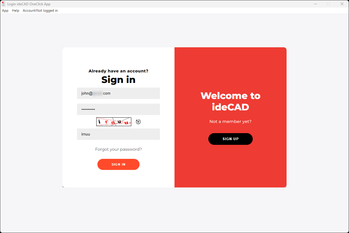

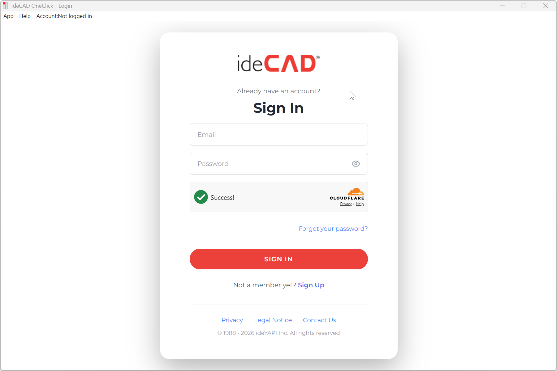

  • Sign in ideYAPI OneClick with the same account on both devices.

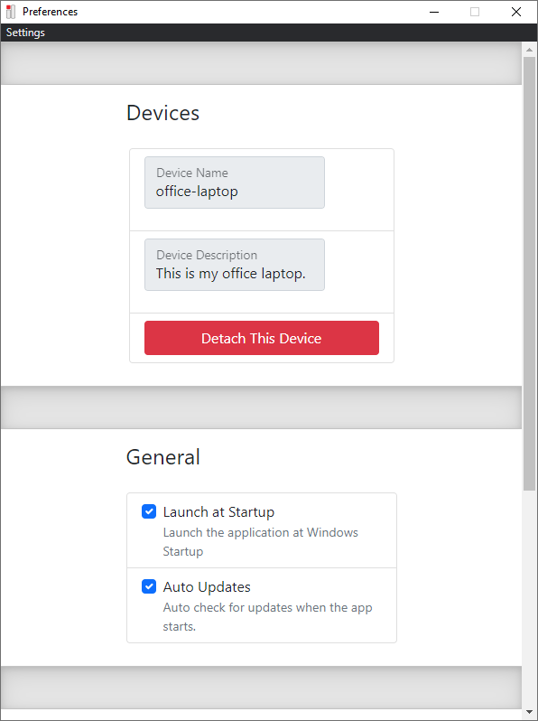

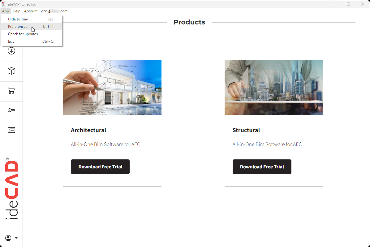

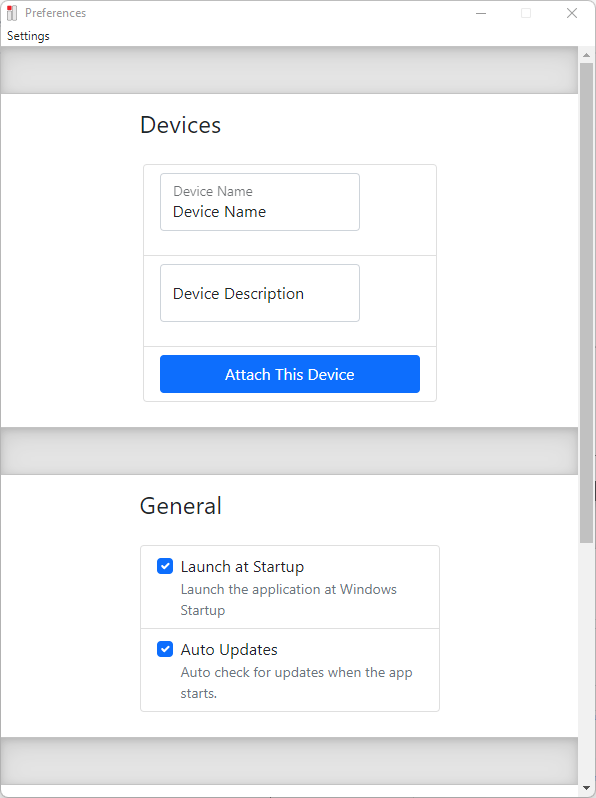

  • Click on the App/References (Ctrl + P) line from the ideYAPI OneClick menu on the device A (office-laptop e.g.).
  • The Settings dialog will open.

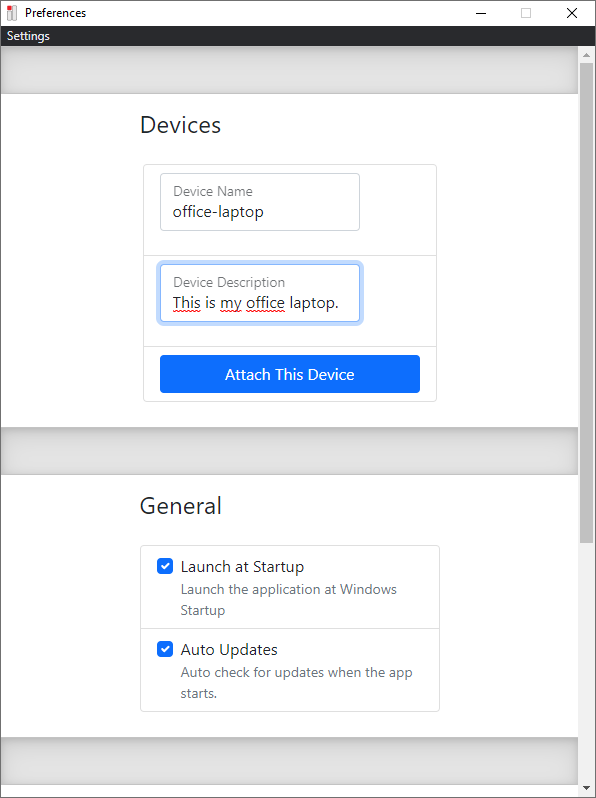

  • Enter the device Device Name and Description.
  • Click on Attach This Device button.
This must be done for both devices.

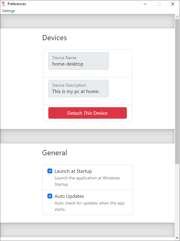

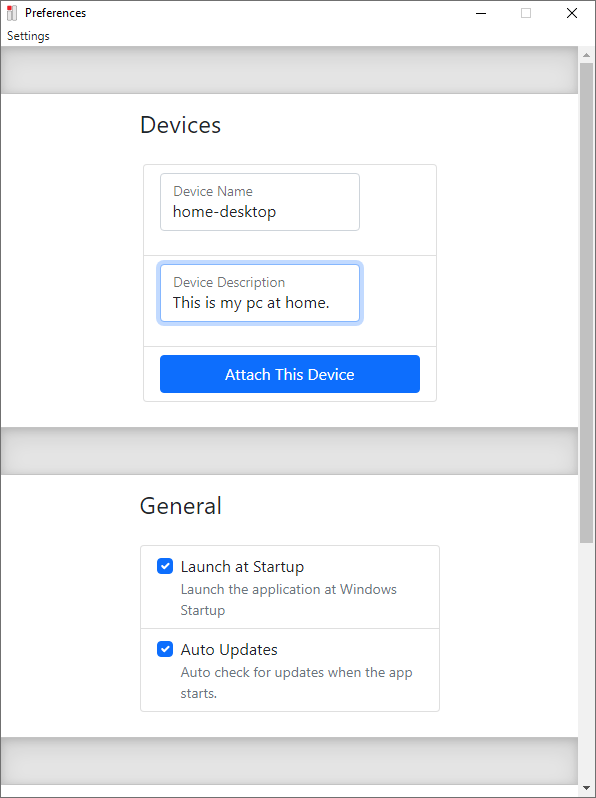

  • Switch to the device B (home-desktop e.g.).
  • Click on the App/References (Ctrl + P) line from the ideYAPI OneClick menu.

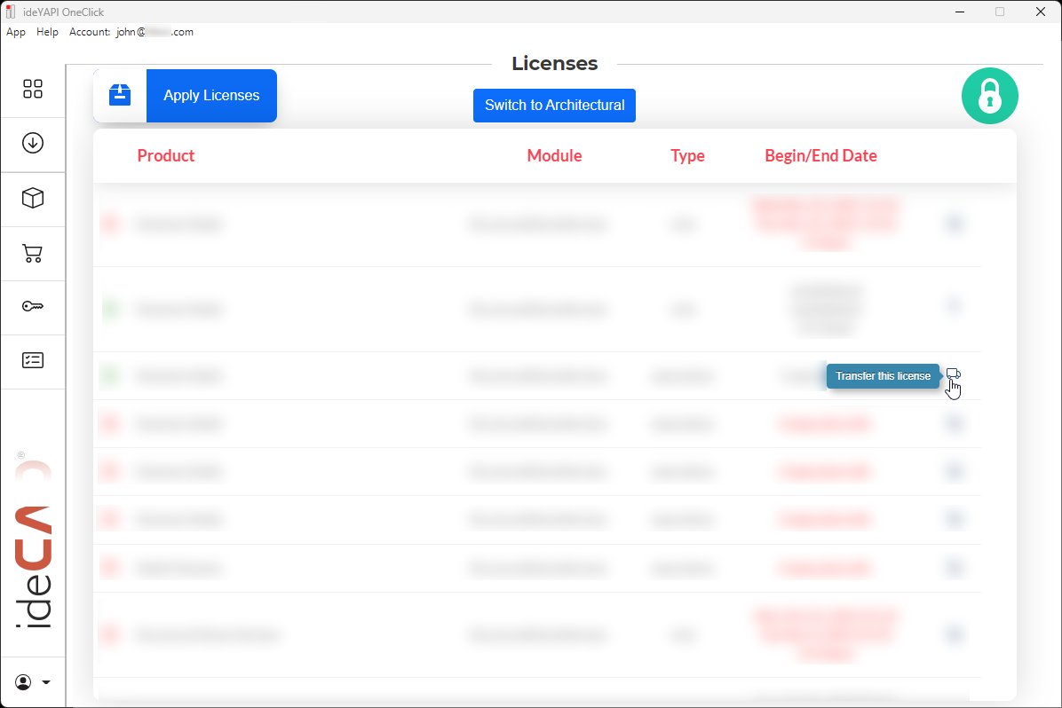

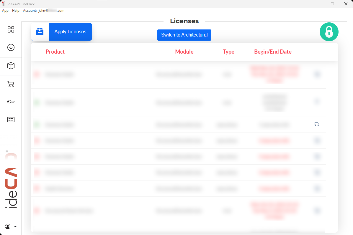

  • Click on the License tab in ideYAPI OneClick .
  • A list of licenses available on the device A (office-laptop e.g.) will open.
  • Licenses with the transfer (truck) symbol at the end of the line can be transferred to the device B (home-desktop e.g.).
  • Click on the transfer icon at the end of the license to be transferred to the device B (home-desktop e.g.).

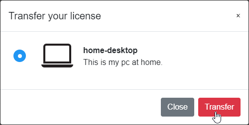

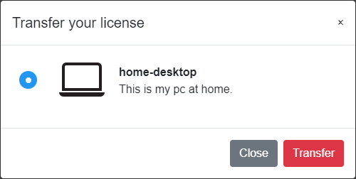

  • Devices registered to the system are listed.
  • The device B (home-desktop e.g.) to be moved is selected.

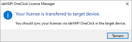

  • Click the Transfer button.
  • Information is given that Your license is transfered to target device. You should sync your license via ideYAPI OneClick in the target device.
As a result of this process, the license on the processed device A (office-laptop e.g.) will be removed. The transferred license is kept in the cloud system.

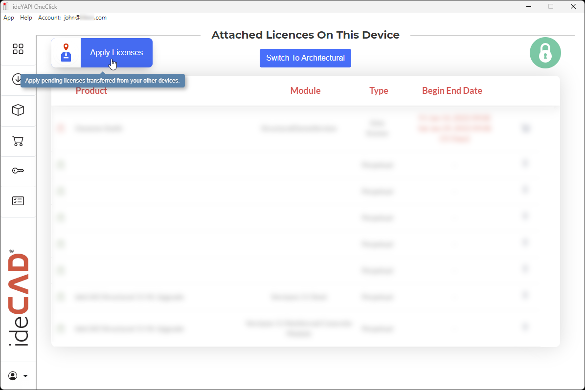

  • Open the ideYAPI OneClick.
  • Click on the License tab.
  • Click the Apply Licenses button on the top left.

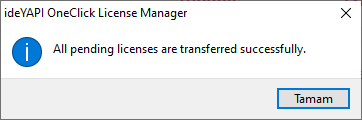

  • The license pending in the cloud is automatically downloaded and activated.
  • Information is given that All pending licenses are transferred successfully.
  • With the transferred license, ideCAD continues to be used.
