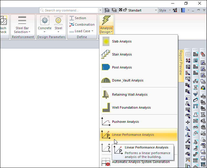

You can access it under the Analysis and Design tab under the Analysis heading.
You can also access the Concrete , Steel , Structural Inspection tabs under the Analysis heading.
  • Click the Linear Performance Analysis icon under the Analysis Design icon .

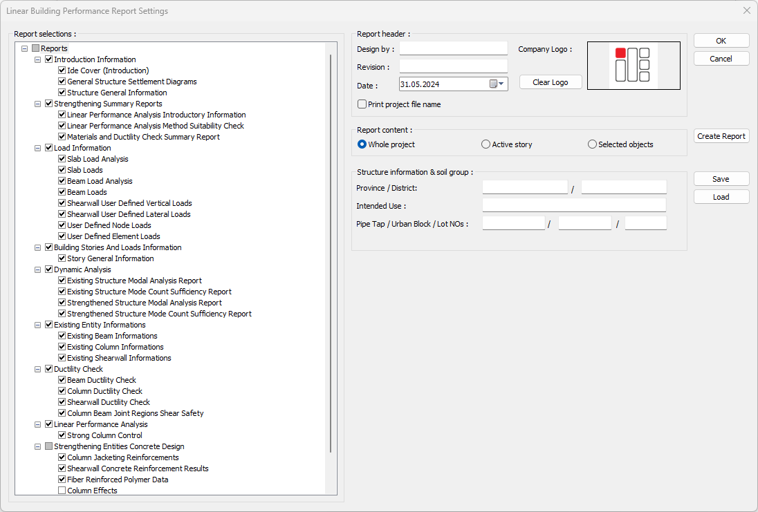

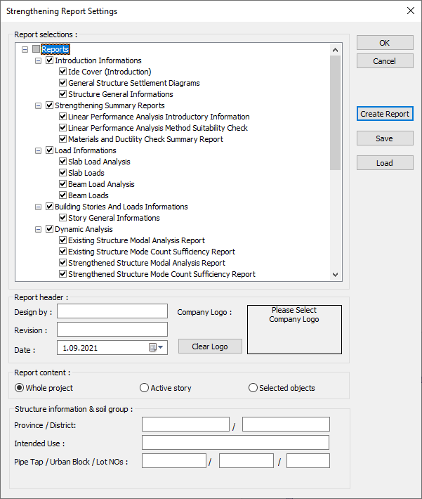

  • The strengthening report settings dialog will appear.
  • After selecting the appropriate report titles, click the Create Report button.

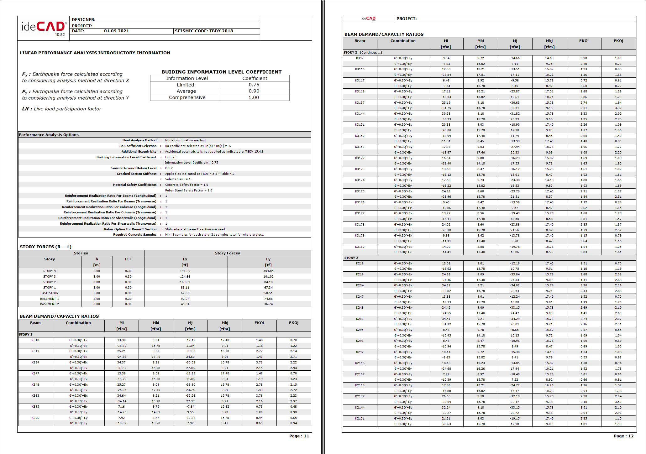

  • The linear performance analysis report will be displayed.
Example linear performance analysis report pages
