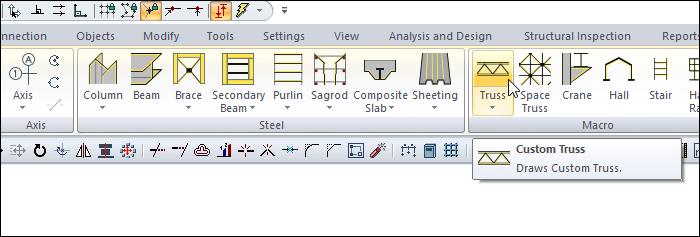

You can access it under the ribbon menu, Steel tab, Macro title
  • Click the Truss icon with the left mouse button in the ribbon menu.
  • The trusses toolbar will open.

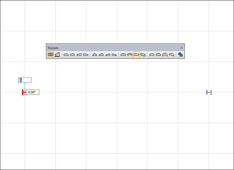

  • Move the mouse cursor over the column. When the cursor changes shape, click the left mouse button. When the cursor changes shape, click the left mouse button.
  • After you have determined the first point of the truss, put the cursor on the second column and create your second point. The program will create trusses.
Creating the first point of the trusses

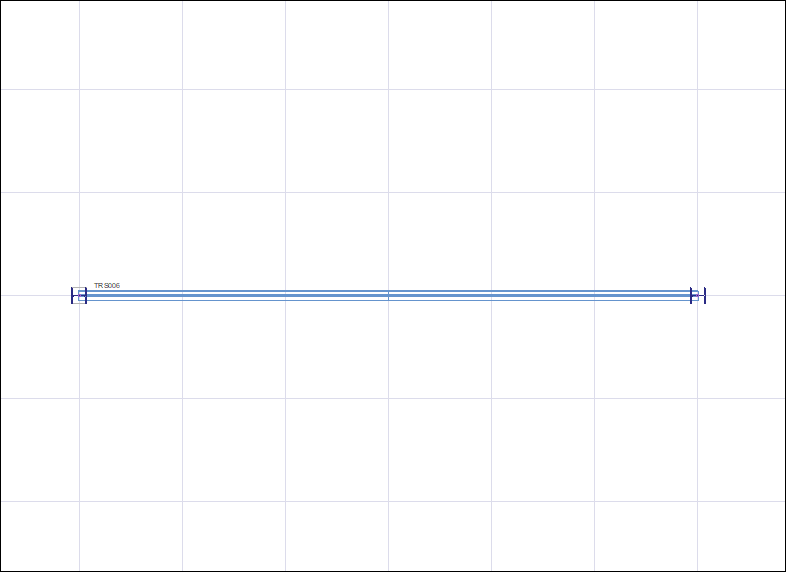

Determination of the second point of the trusses and formation of the trusses

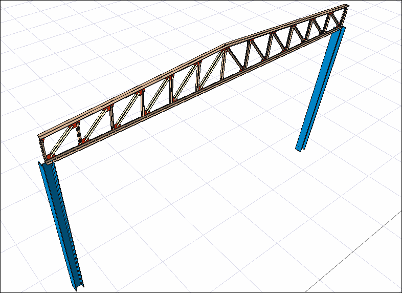

Prepared Truss Type
