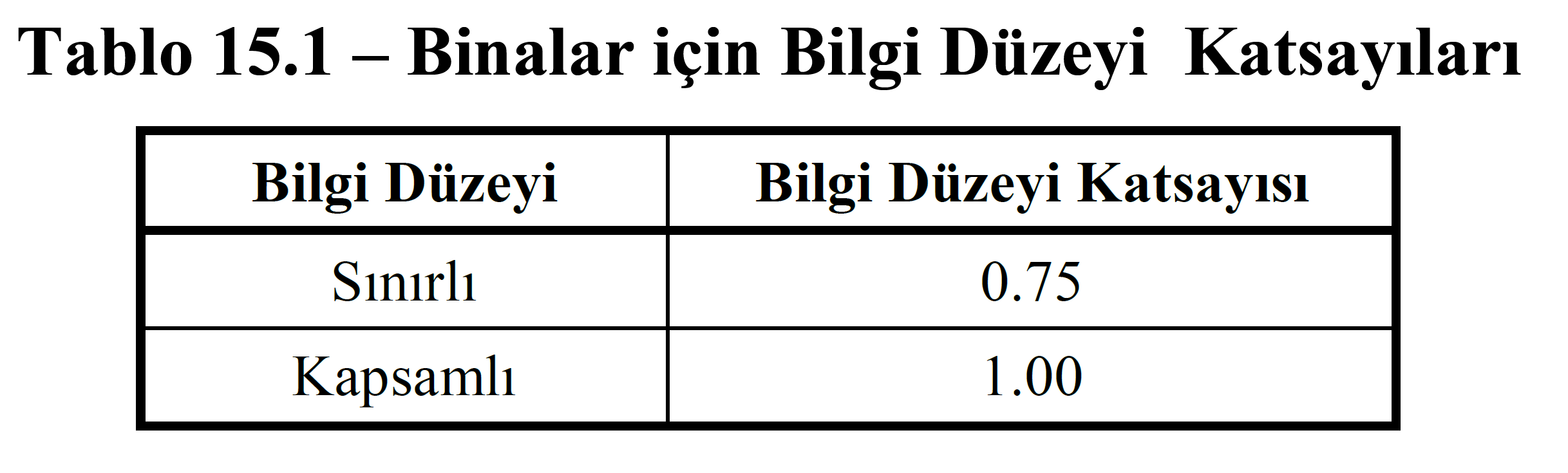

15.2.12. Knowledge Level Coefficients
(a) The Knowledge Level Coefficients to be applied to the staff capacities according to the knowledge level obtained from the buildings examined are given in Table 15.1 .
(b) Unless specifically stated, material strengths shall not be divided by the material coefficients given in the relevant design regulations. Existing material strengths will be used in the calculation of element capacities .
