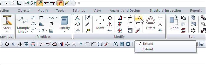

Location of the Extend Command
You can access the Extend command under the Modify title of the ribbon menu Drawings tab .
  • Click the Extend icon in the ribbon menu .

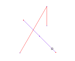

Determining the reference limit

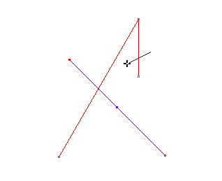

Determining the side to be extended

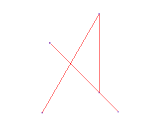

After extend
