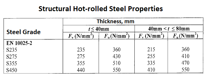

Fy = Structural steel characteristic yield stress
Fu = Structural steel characteristic tensile stress
t = Thickness

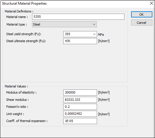

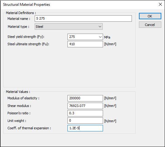

  • S355 is chosen for steel columns and S275 is chosen for steel beams.
  • Material arrangements with ideCAD Structural are shown in the image below.
