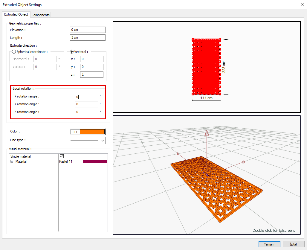

You can access the local rotation feature from the extruded object settings dialog.
Features
X rotation angle
The angle of rotation relative to the local X axis is entered.
Y rotation angle
The angle of rotation relative to the local Y axis is entered.
Z rotation angle
The angle of rotation relative to the local Z axis is entered.

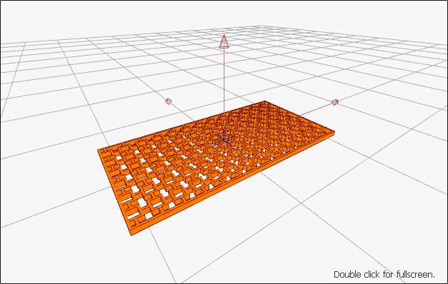

When the rotation angle X, Y and Z is 0

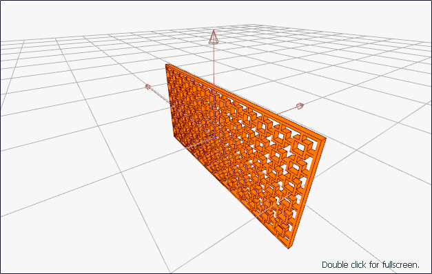

When the rotation angle X 90, Y and Z 0

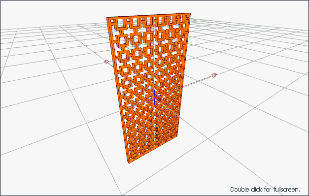

When the rotation angle Y 90, X and Z 0

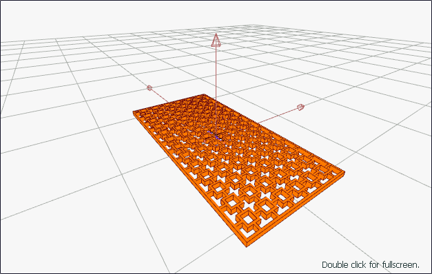

When the rotation angle Z 90, X and Y 0

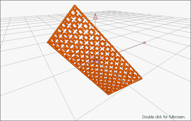

When the rotation angle is X 90, Y 45 and Z 135
