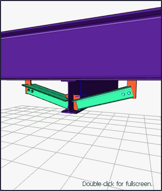

Defining a Stay Connection

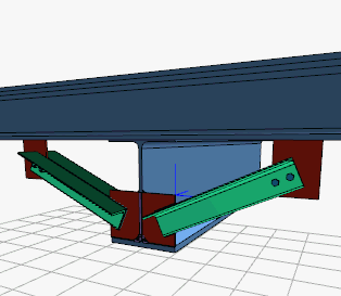

With the Stay Connection command, beam-beam connection is defined. It connects the steel beams that connection at different levels to each other with angle plate.

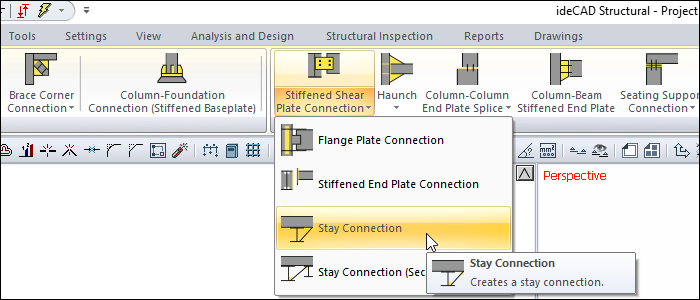

Location of the Stay Connection Command
For two beams whose elevation is different but intersecting;
  • From the Connection menu, click the Stay Connection icon.
  • First choose the bottom beam. Then select the parts of the other beam in turn and press the right mouse button

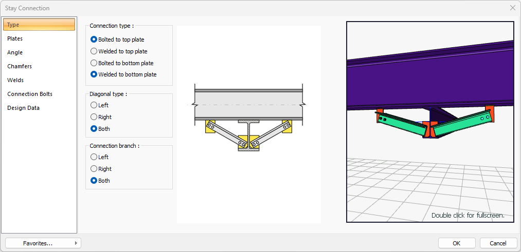

Type Tab
Connection type
Connection type is selected for top and bottom plates.
Crosses
It is chosen whether the crosses will be on the left or right or both sides.
Connection branch
It is selected whether the connection will be on the left or right or both sides.

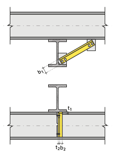

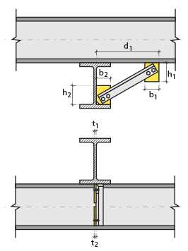

Support plate
The support plate is determined by entering the value. The values ​​to be entered are shown in the schematic drawing.
Secondary plate
The secondary plate is determined by entering the value. The values ​​to be entered are shown in the schematic drawing.
Diagonal plate
The diagonal plate is determined by entering the value. The values ​​to be entered are shown in the schematic drawing.

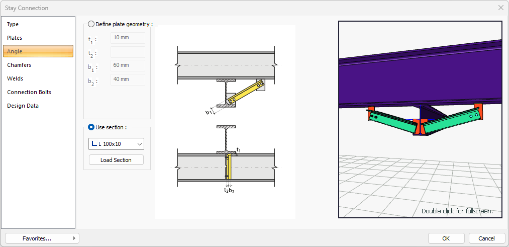

Angle Tab
Define plate geometry
If the option is selected, it is determined by entering the angle values. The values ​​to be entered are shown in the schematic drawing.
Use section
By selecting the option, one of the ready-made L profiles is selected from the list as an angle. By clicking on the load section button, you can reach the ready section library and reach the list of American and European finished rolling sections and select from the list.

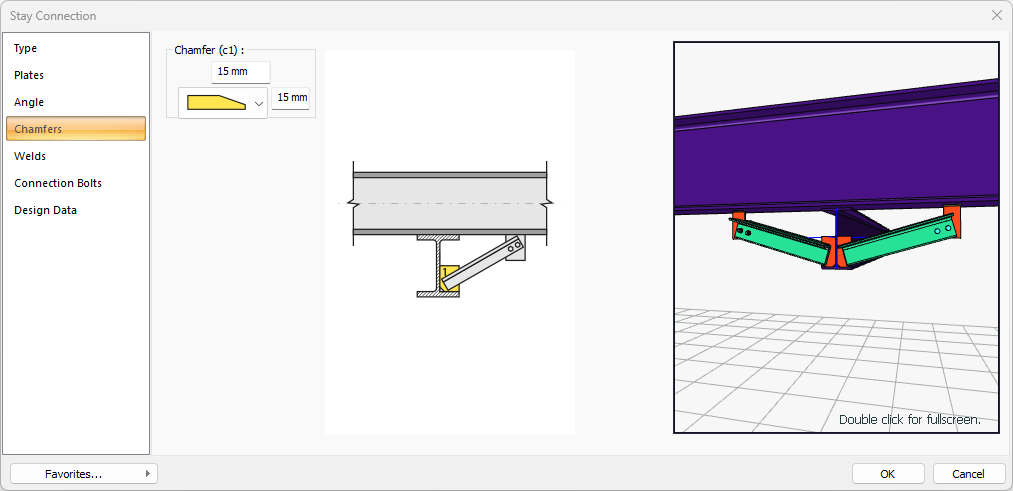

Chamfers Tab
Chamfer (c1)

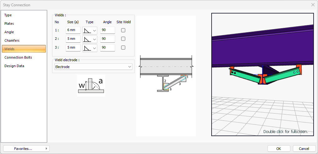

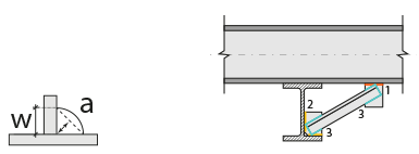

Welds Tab
Welds
Weld electrode

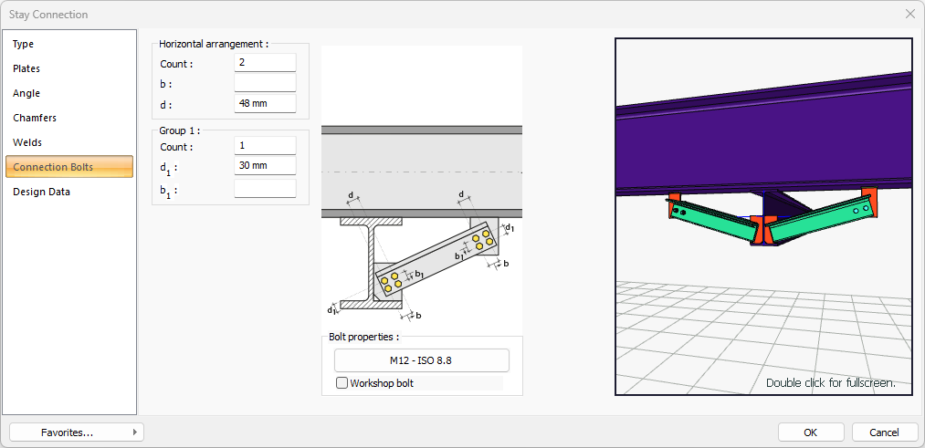

Connection Bolts Tab
Horizontal arrangement
Group 1
Bolt properties

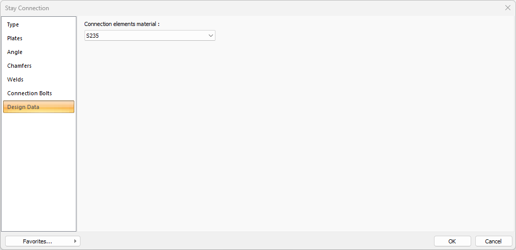

Design Data Tab
