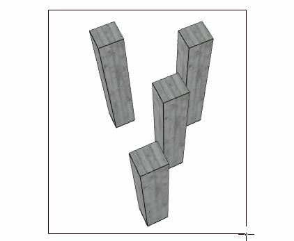

Align Entities
With the Align entities command, objects in architectural and structural projects are aligned in a single operation. Selected objects are aligned in that direction by referencing an object.

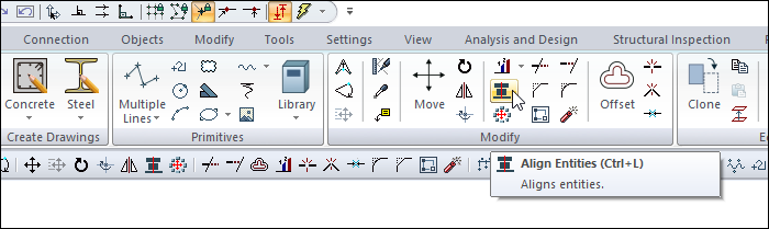

Location of the Align Entities Command
You can access the Align objects command under the ribbon menu Drawings tab , under the title Modify.

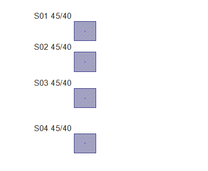

  • Click the Align Entities icon in the ribbon menu .
  • Select the alignment method that suits your process from the align toolbar that opens.
  • Select the object or entities to be aligned.
  • Select the reference object.
  • The process will be completed.

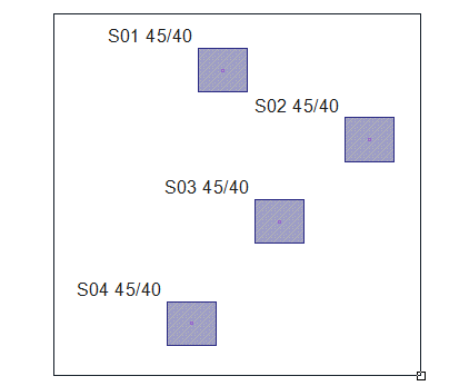

Selecting the object/objects to be aligned

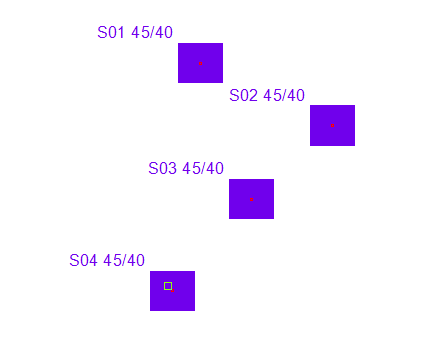

Selecting the reference object

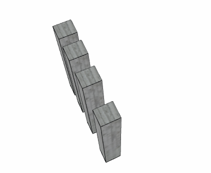

After align entities
