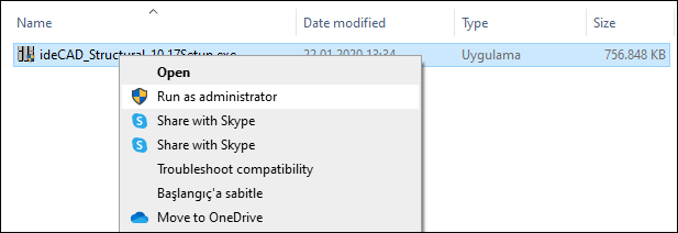

Situation 2
After pressing the right button on the setup file, run the setup by clicking "Run as administrator" from the menu that opens.
