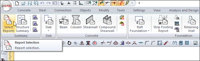

Location of the Select Report Command
You can access it under the ribbon menu reports tab, Summary heading.

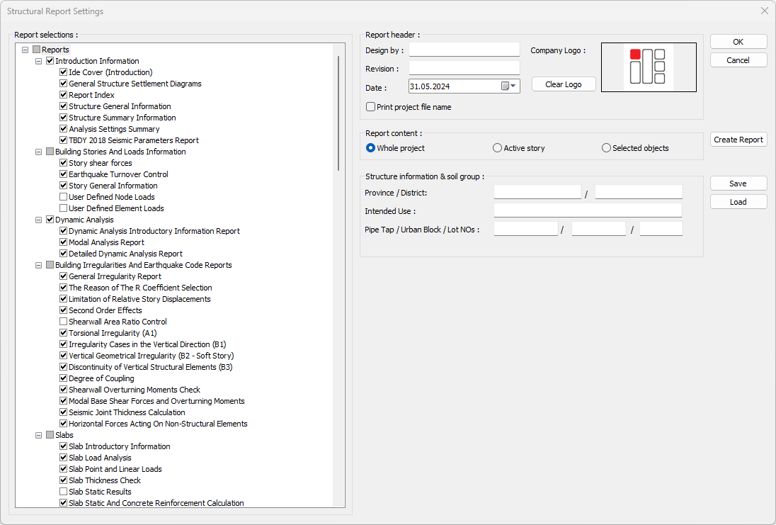

  • Click the Select Reports icon. The structural report settings dialog will open.
  • In the dialog that opens, click the Create Report button.

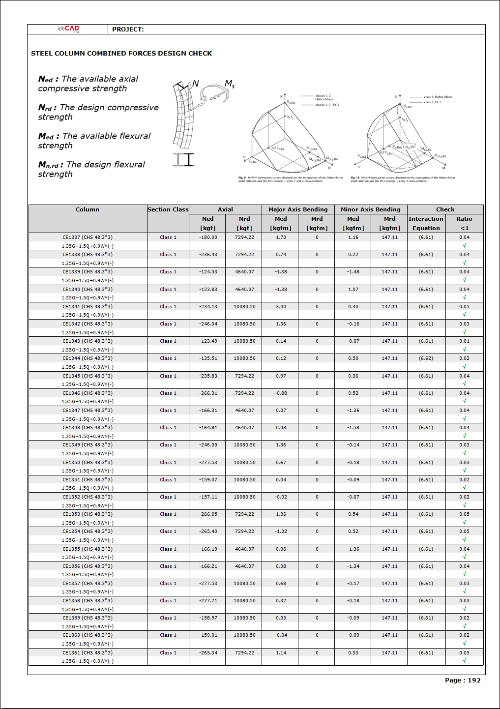

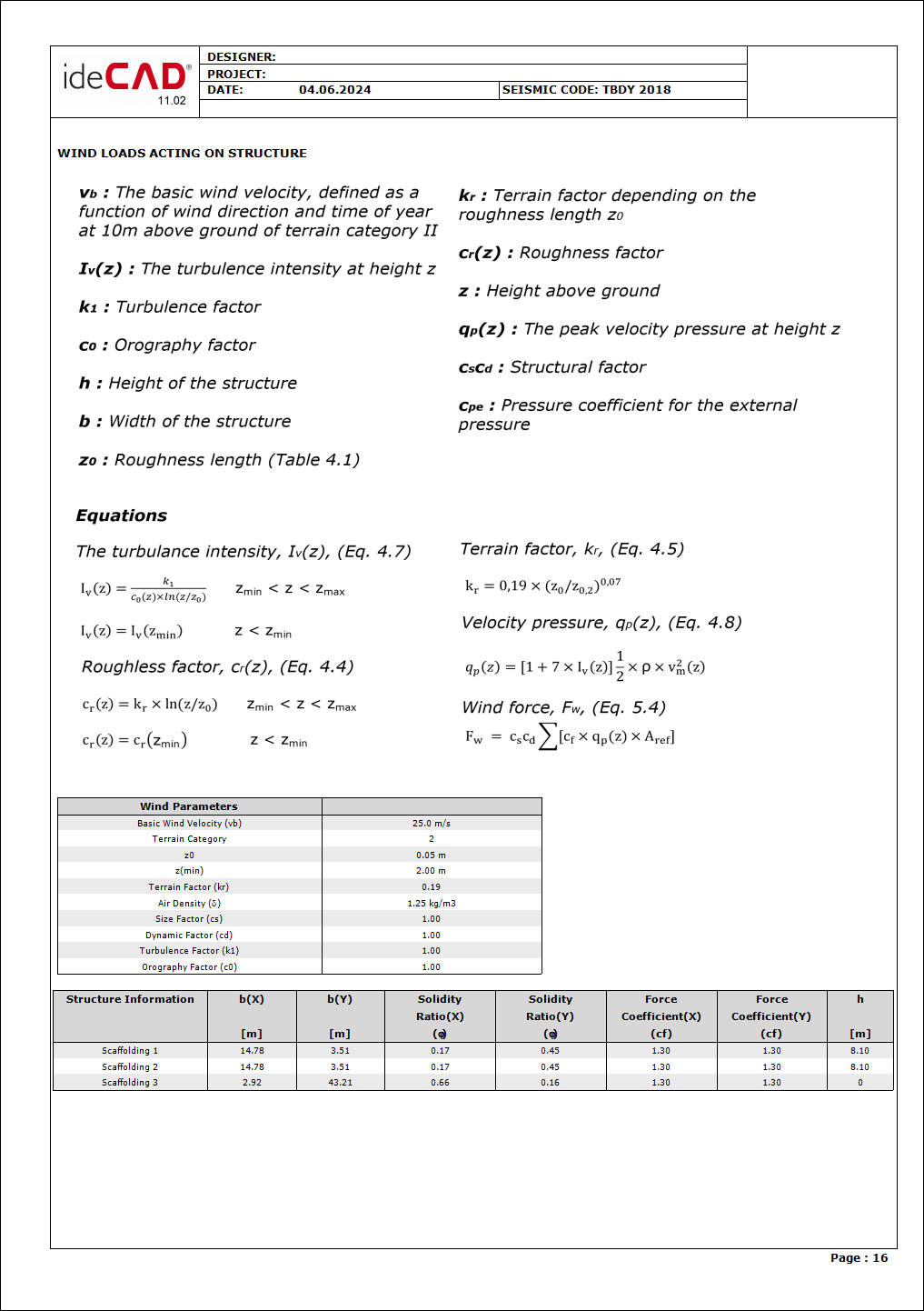

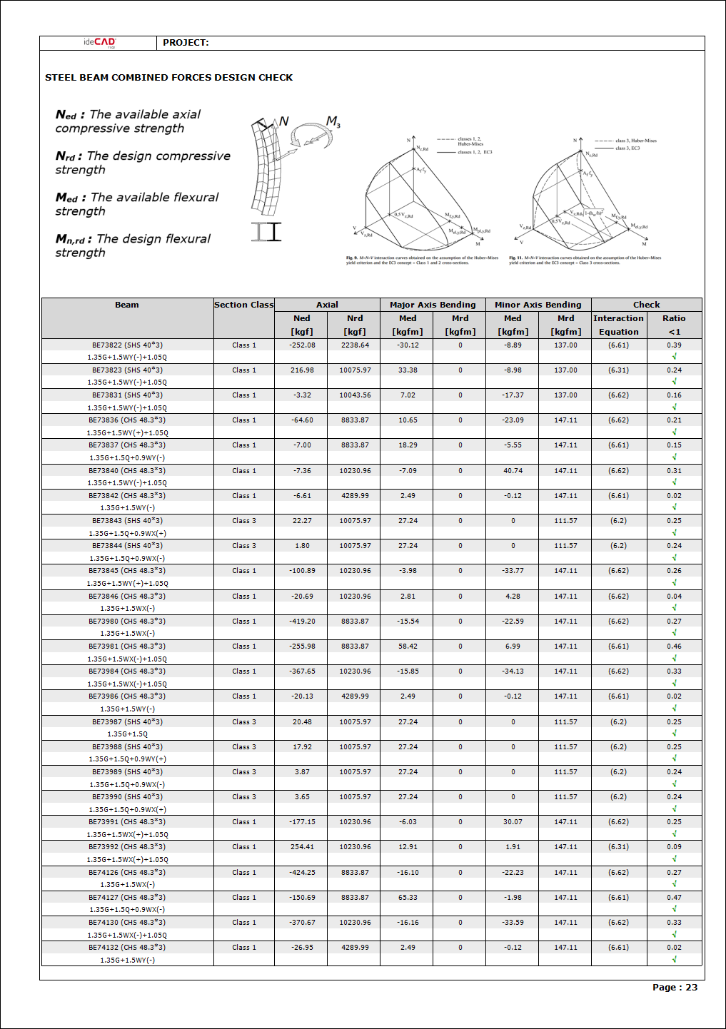

Sample facade scaffolding report pages
Static Report Settings

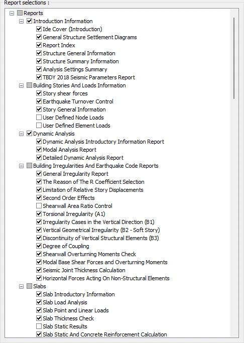

Report selection
The reports that can be received are listed.
Design by
The designer's information is entered.
Revision
Revision information is entered.
Date
The report date is entered.
Company logo
The company logo is added, the existing logo is deleted.
Whole project
A report for the entire project is created.
Active story
The active floor report is created.
Selected objects
The selected objects report is created.
Province/District
The province/district information where the project will be done is entered.
Intended use
The intended use of the building is entered.
Pipe tap/Urban block/Lot NOs
The pipe tap, urban block and lot no information of the land where the building will be built is entered.
Create report
The report is created by clicking.
Save
Saves the report.
Load
Loads the previously saved report.
