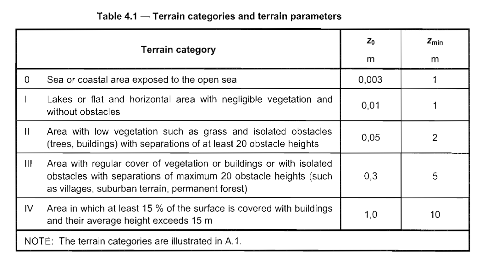

Terrain Roughness Factor
The procedure for determining cr(z) may be given in the National Annex.
The roughness factor, cr(z), is calculated as below,
Terrain factor kr depending on the roughness length zo calculated using equation below.
zo, zmin depend on the terrain category.
