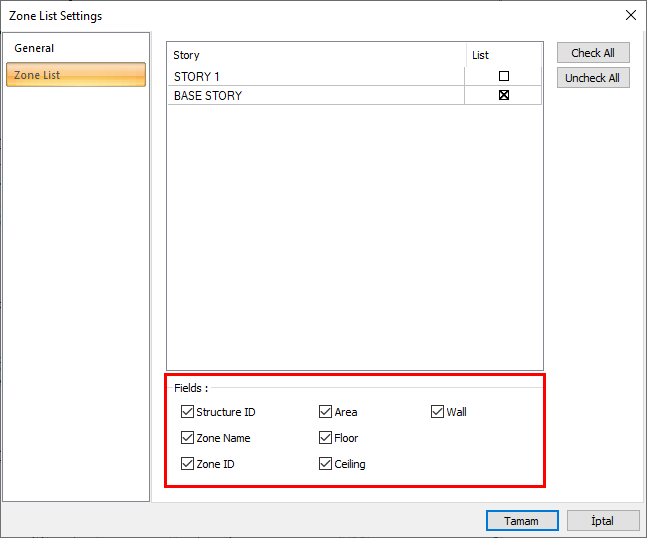

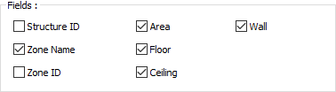

Fields settings, structure ID, zone name, zone ID, area, floor, ceiling and wall information are given in the zone list. The desired fields are marked in the zone list settings dialog.
Location of Fields Settings
You can access the fields settings from the zone list tab of the zone list settings dialog.
Structure ID
If checked, the name of the building is shown in the zone list.
Zone name
If checked, the name of the zone is shown in the zone list.
Zone ID
If it is checked, the location label is shown in the site list.
Area
If it is checked, the area is shown in the zone list.
Floor
If marked, it will be shown in the floor zone list.
Ceiling
If marked, it is shown in the ceiling zone list.
Wall
If checked, the wall is shown in the zone list.

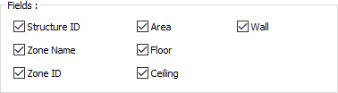

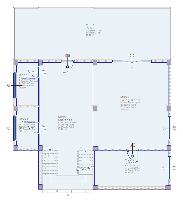

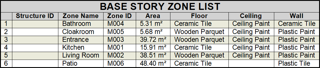

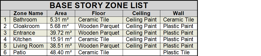

Sample Zone Lists
When all field options are checked
When structure id and zone id are unchecked

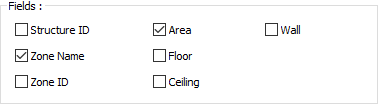

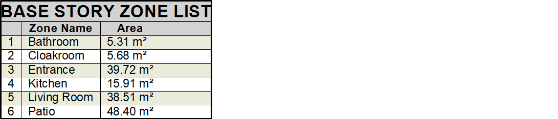

Only when zone name and area are marked
