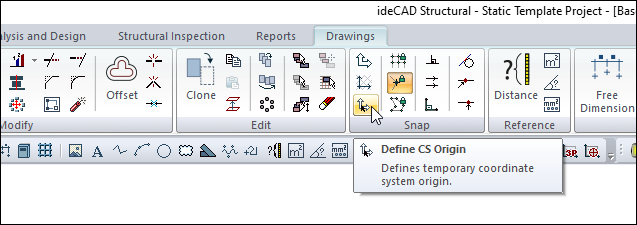

Location of the Define CS Origin Command
You can access it from the Snap title of the Drawings tab in the ribbon menu.
  • Click the Define CS Origin icon in the ribbon menu .
