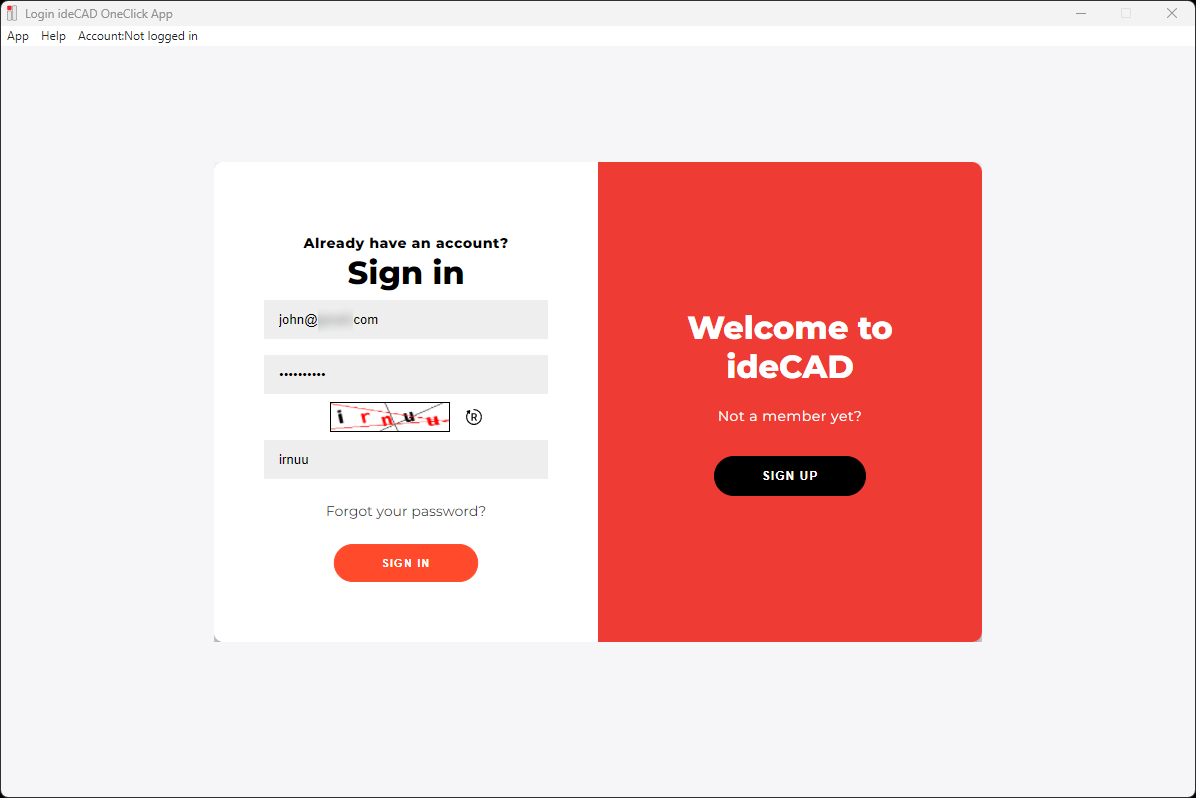

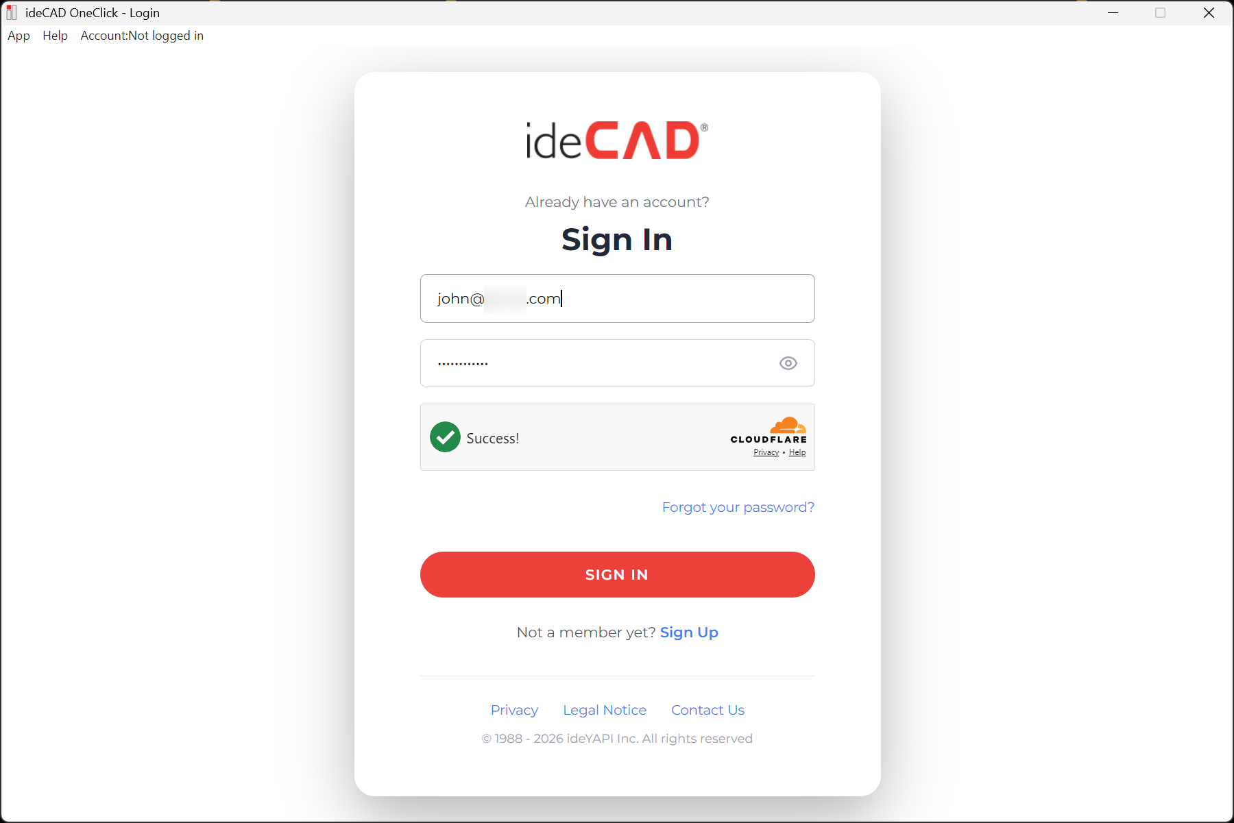

  • Open ideYAPI OneClick and sign in with your MyAccount information.
  • Enter your email and password.

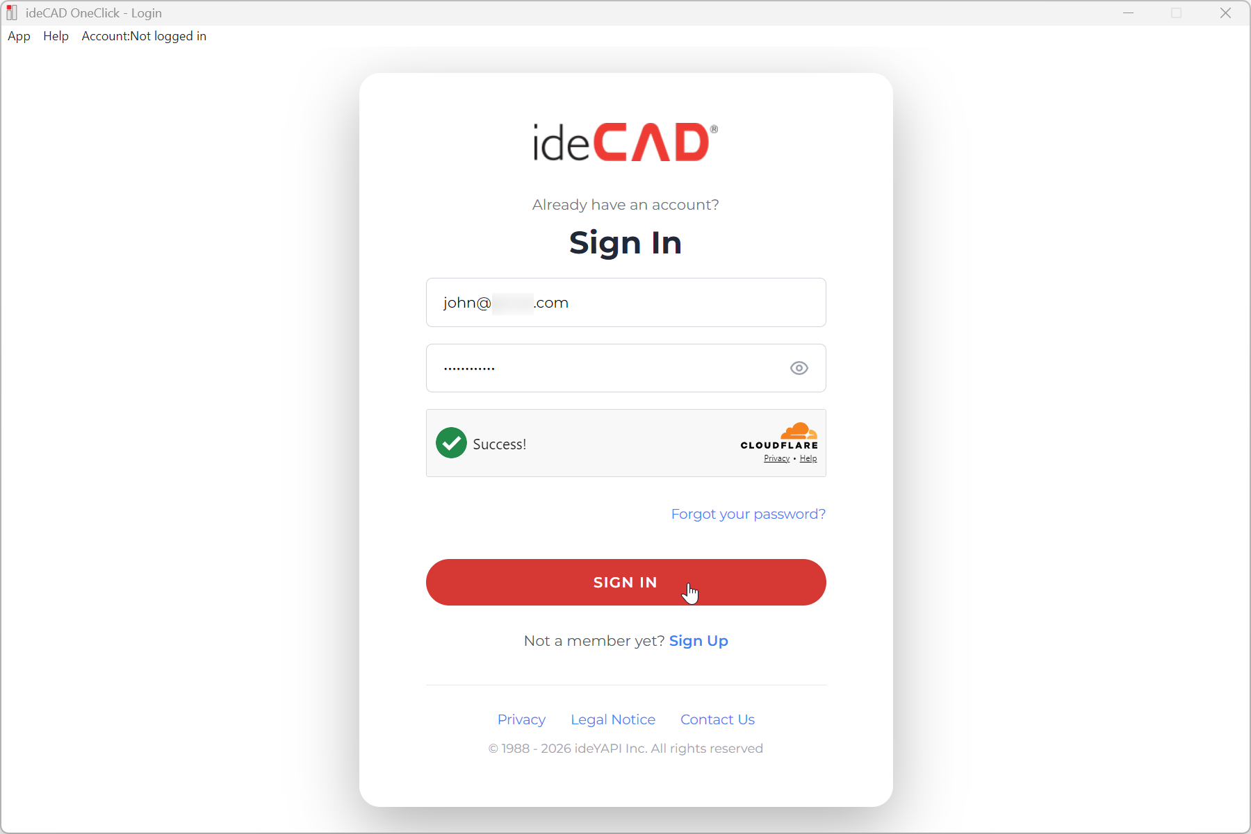

  • Click on the Sign In button.
  • ideYAPI OneClick will open.

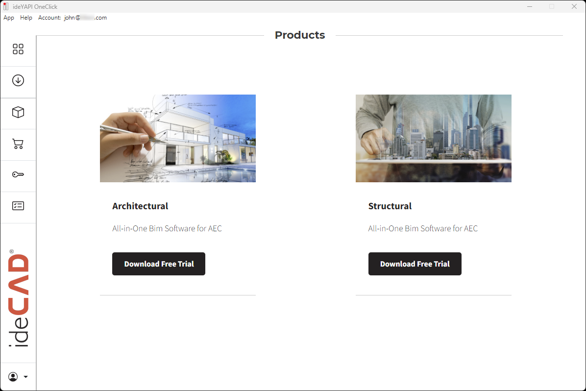

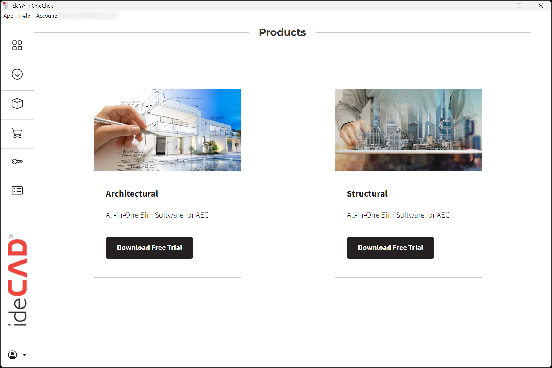

Products Tab
Architectural and Structural Trial versions are available from the Products tab.

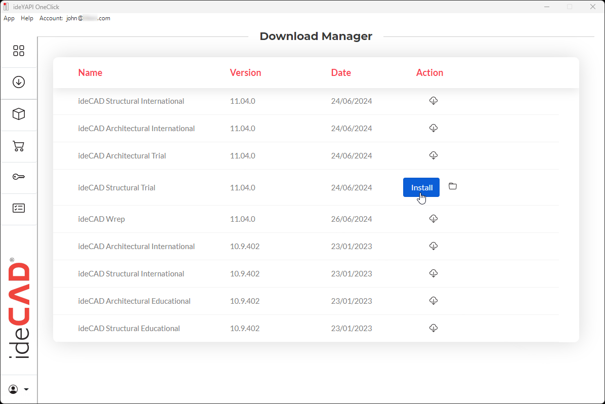

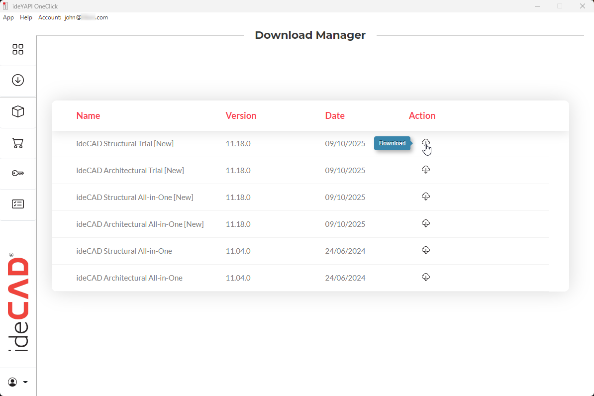

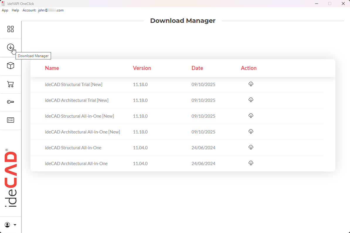

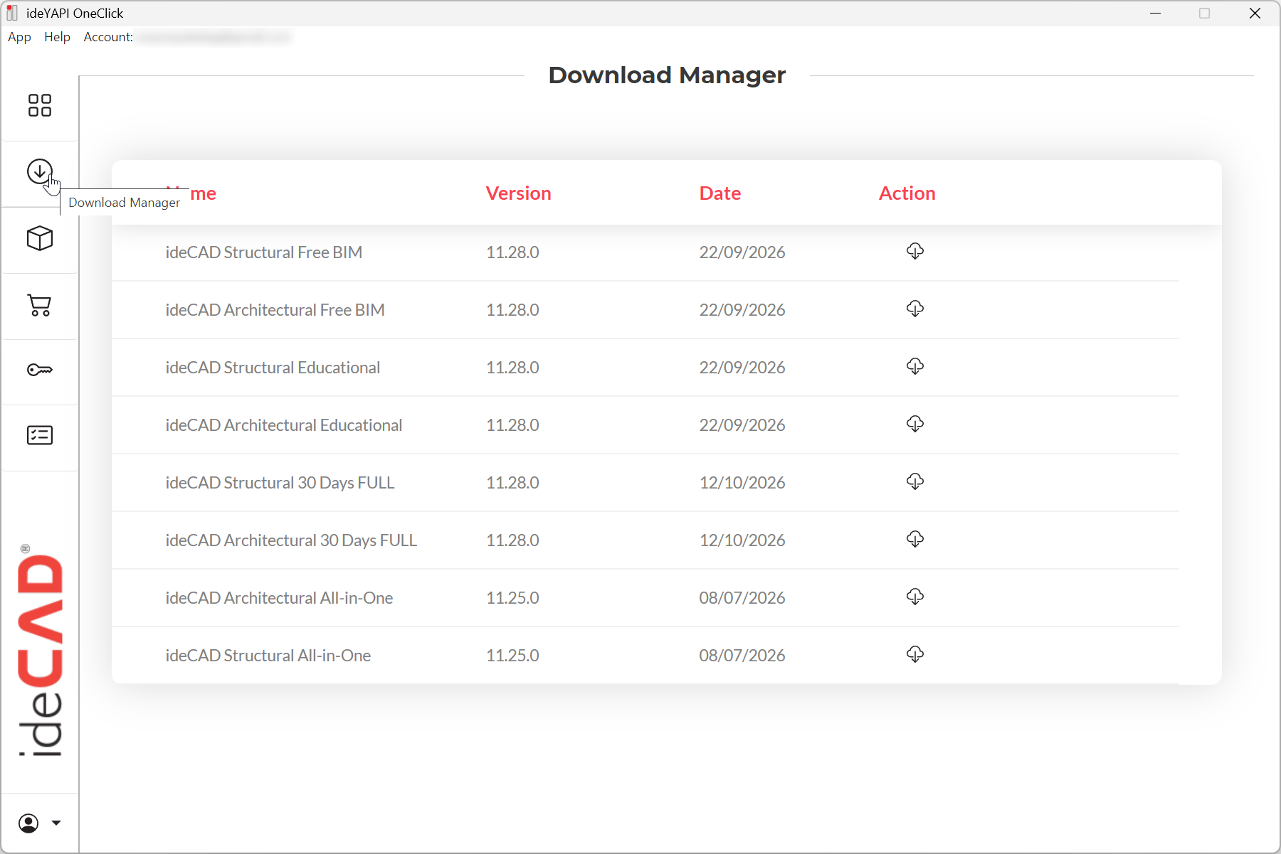

Download Manager Tab
From the download manager tab, you can access the ideCAD applications and versions to be downloaded.
The desired ideCAD application is downloaded by clicking the download icon.

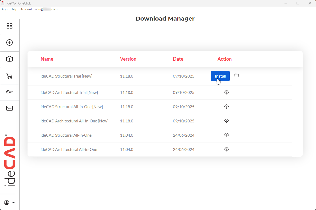

After the download is complete, the installation will start automatically.
If it is not started, click the open folder icon to open the folder and start installation process manually.

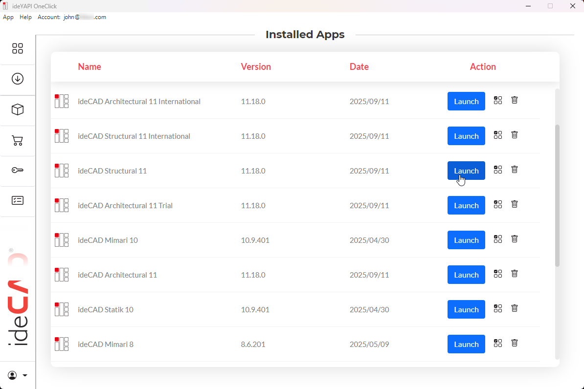

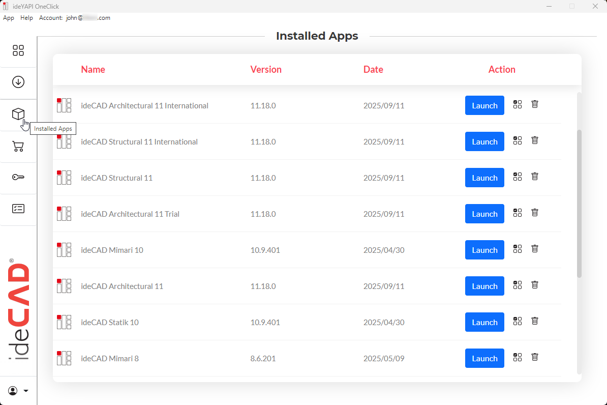

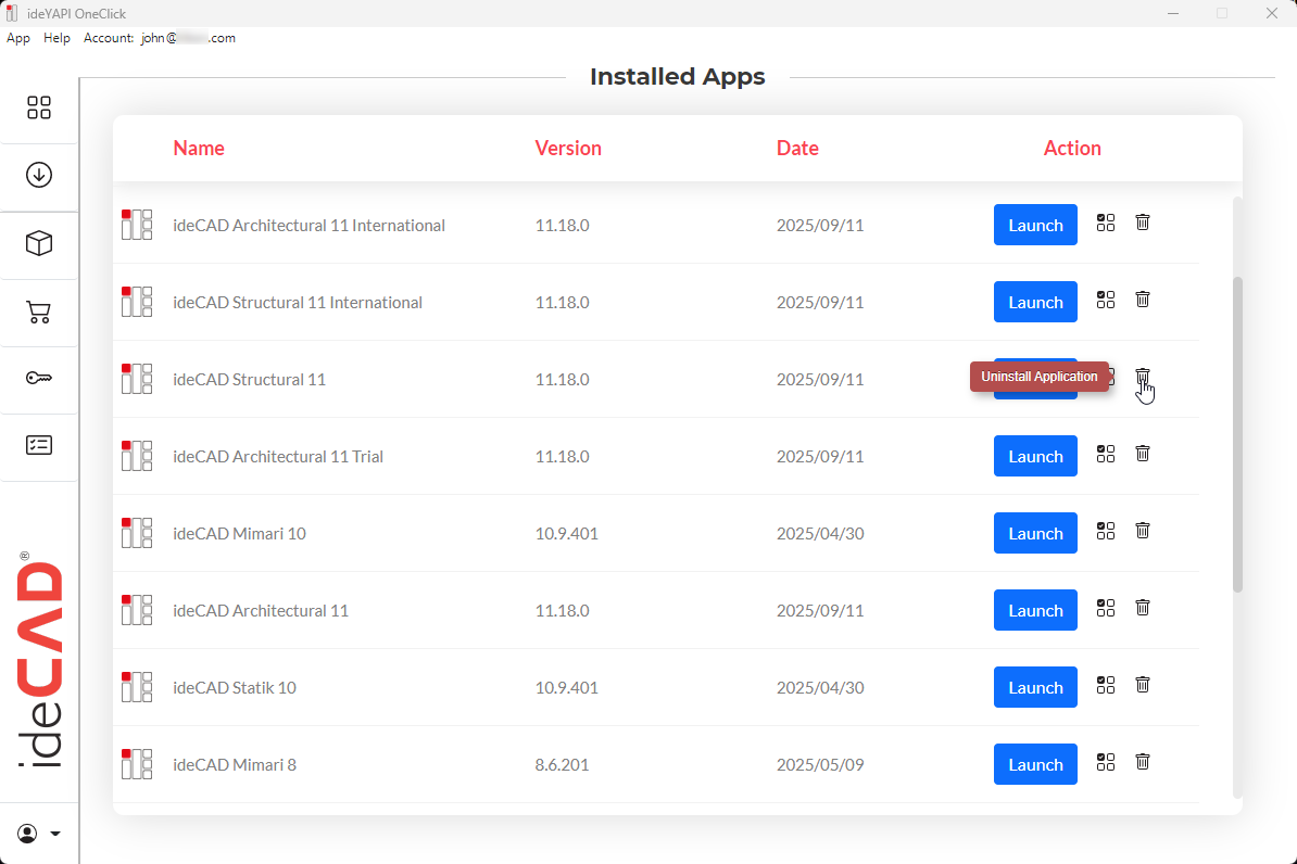

Installed Applications Tab
The Installed applications tab lists the ideCAD applications installed on the computer.
ideCAD opens by clicking the Launch button.
By clicking the uninstall application icon, the clicked ideCAD application is un install from the computer.

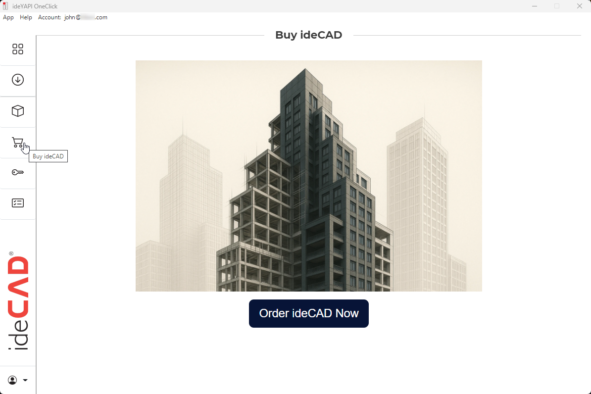

Buy ideCAD Tab
From the buy ideCAD tab, you can subscribe ideCAD application for 3 years.

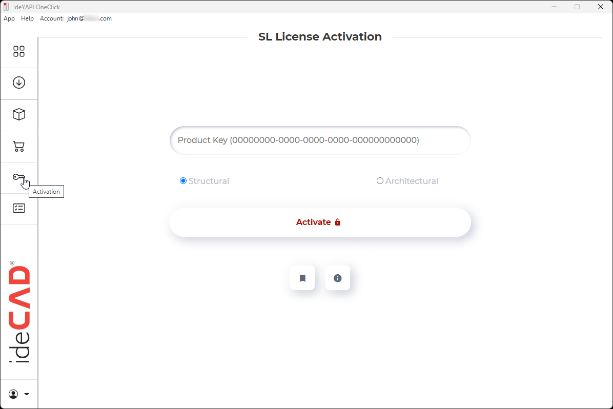

Activation Tab
With product key you can activate your licence from the activation tab.

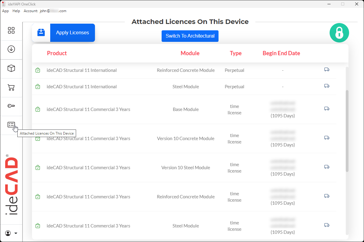

Attached Licences on This Device Tab
The licenses attached to the computer are listed. The license transfer process is done from this tab. You can find detailed information about license transfer here.

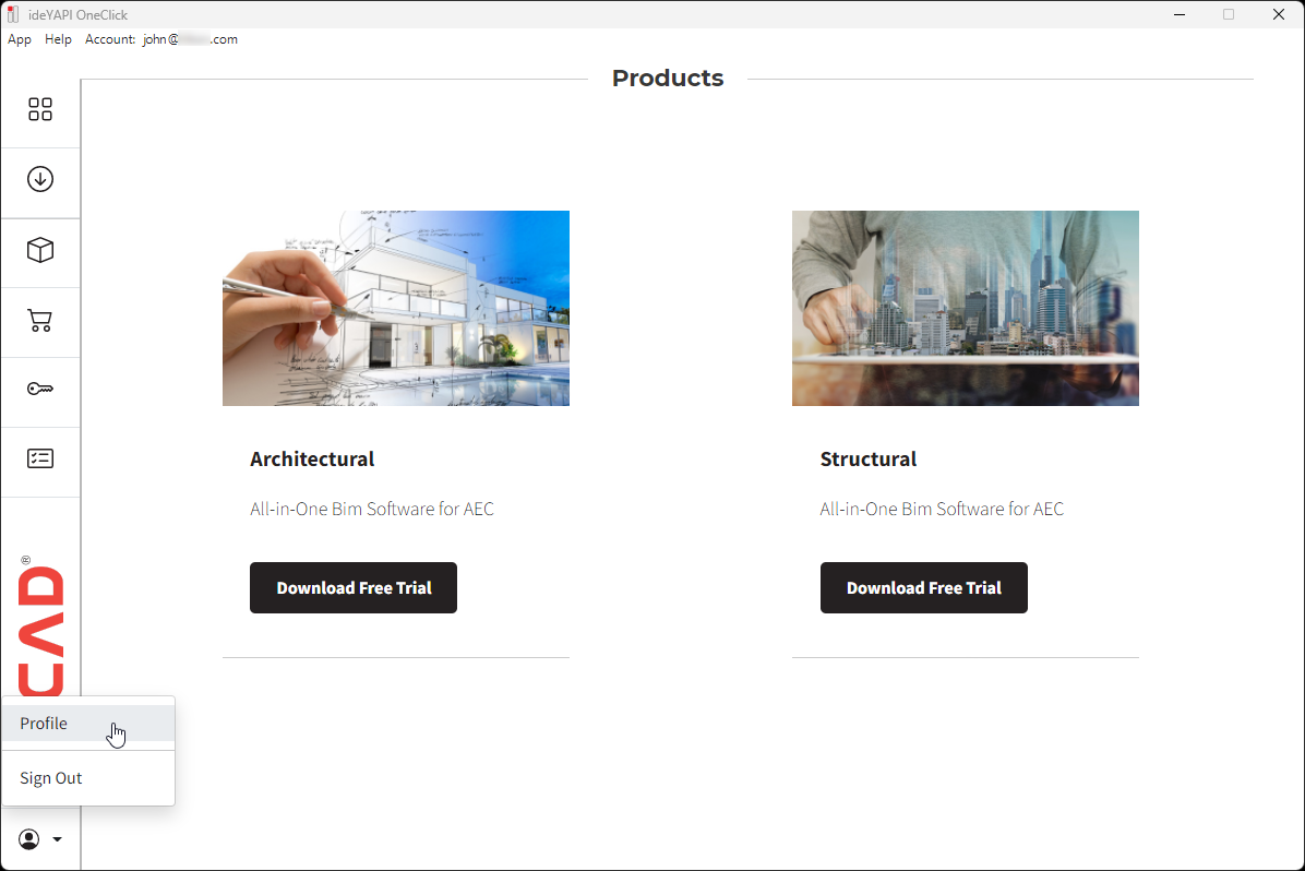

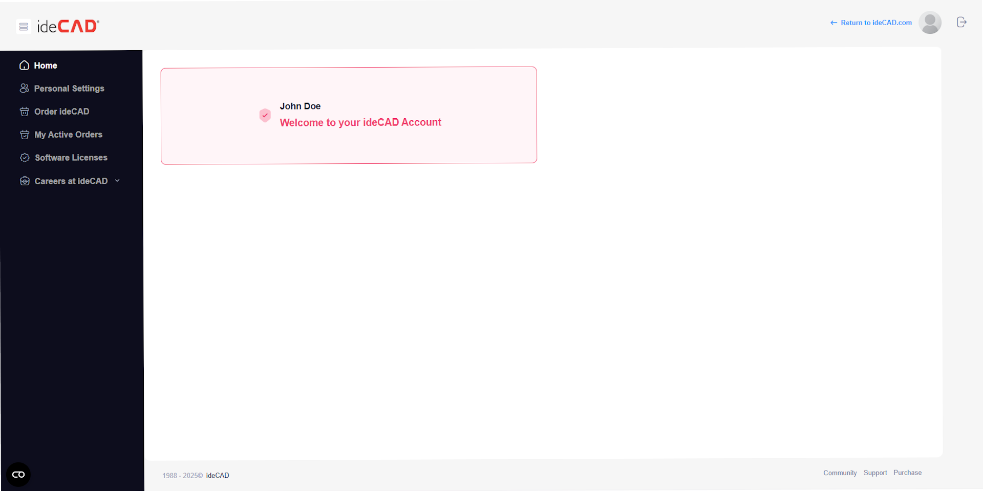

Switching to MyAccount via ideCAD OneClick
Click on the profile line opens the ideCAD MyAccount page.
