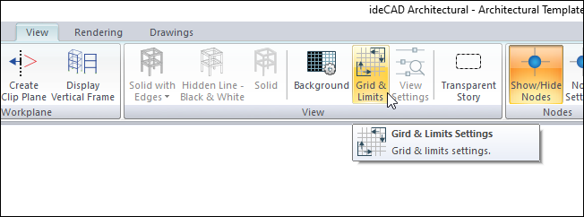

Location of the Helper Grid Settings
You can access it under the ribbon menu View tab, View title in the architectural program.
You can also access it from the Preferences tab in the Preferences.

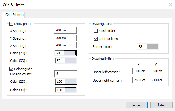

Grid and Limits Settings
Helper grid
By checking the option, helper grid become visible between the grid lines.
Division count
The distance between the helper grid lines is entered.
Color (2D)
The color of the helper grid is selected for 2D windows.
Color (3D)
The color of the helper grid is selected for 3D windows.
Show Helper Grid
To turn the helper grid lines off and on;
  • Click on the grid and borders icon.
  • The helper grid option is marked by clicking with the left mouse button.
  • The dialog is exited by clicking the OK button. Helper grid will open and appear in the drawing area.
  • Likewise, if the option is unchecked by clicking the left mouse button, it will not appear in the drawing area that will be closed to the helper grid.
  • If the entered grid system settings are to be applied to all windows in the project, the Apply settings to all drawing windows line in the Preferences dialog is highlighted.

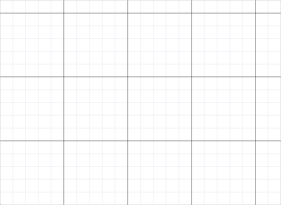

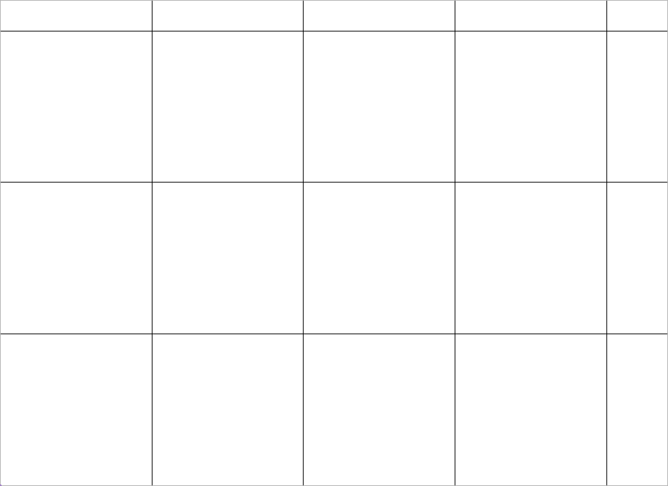

When the helper grid are not marked
When the helper grid are marked

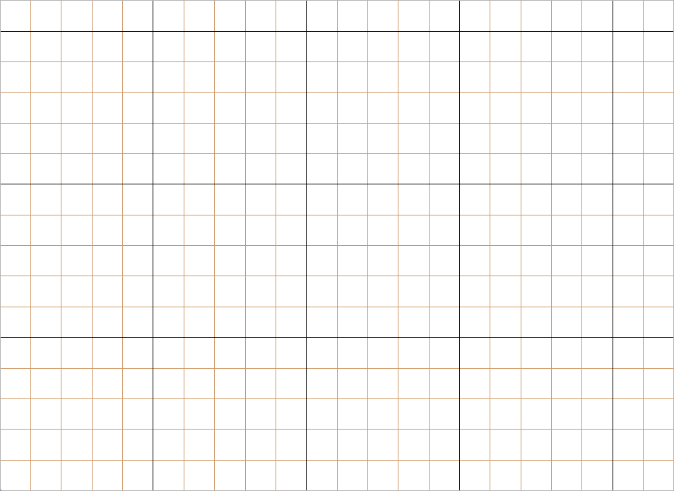

Helper grid in gray
Helper grid in brown
