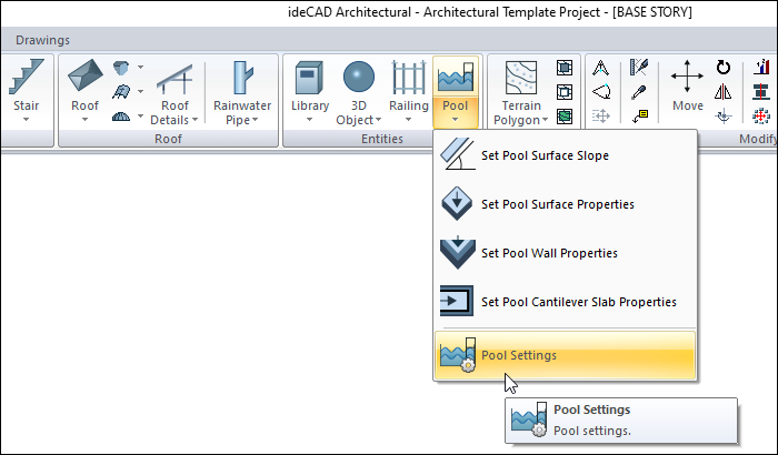

Pool Settings
With the Pool Settings command, settings such as elevation, drawing, material selection, structural material, pool depth, wall thickness are accessed.

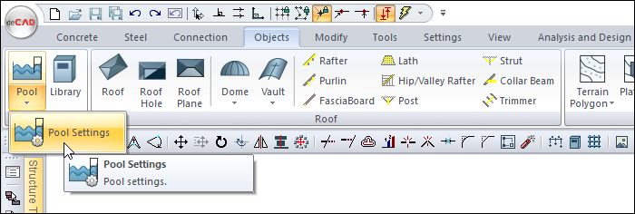

Location eof Pol Settings Dialog
The pool that appears after the pool command is run in the assistant toolbar.
You can access under the ribbon menu Home tab, Roof title.
In Structural Program
You can access under the ribbon menu, Objects tab, Entities title.

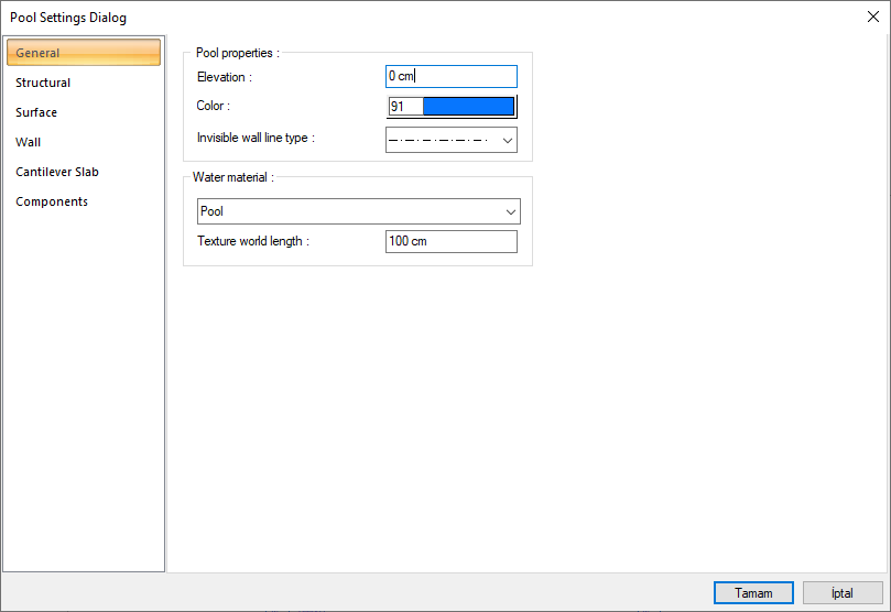

Elevation
Enter the height (elevation) of the pool from the ground. Zero floor floor and pool floor coincide.
Enter the color of the pool lines. You can choose the color you want from the dialog that opens when the button is clicked.
Invisible wall line type
Determine the line type of the wall lines remaining in the background in the pool from the list.
Water material
For the solid model, select the material (texture) of the water from the drop-down list.
Texture world length
Texture length is entered. For example; If 1 is entered, the width of the selected material texture will be taken as 1 unit and will be covered on the selected object. If the texture is considered to be in the form of a square, the object surfaces are covered with 1x1 textures aligned side by side.

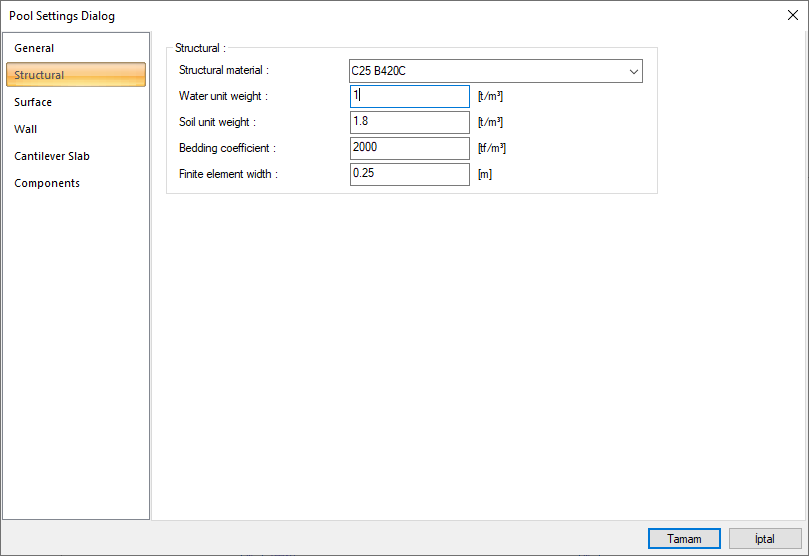

Structural Tab
Structural material
Select the structural material to be used in the pool calculation from the list. Structural material can be defined as a reinforced concrete element under Materials in Building Tree.
Water unit weight
Unit weight of water is entered. The default value of the program is equal to 1 t / m 3 and normally you do not need to change it.
Soil unit weight
Give the soil unit weight of the floorr on which the pool sits.
Bedding coefficient
Give the bedding coefficient of the floor on which the pool sits.
Finite element width
Enter the maximum finite element width to be taken as basis in shell calculation. The program analyzes shells by dividing them into trapezoidal form finite elements. Finite element width is automatically adjusted according to the shell shape, provided that it does not exceed the value entered in this row.

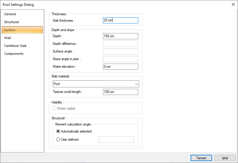

Surface Tab
Slab thickness
Give the thickness of the pool slab.
Depth
Give the measured height of the water surface above the floor of the pool.
Depth difference
Check out setting swimming pool surface slope and setting the swimming pool surface properties.
Surface angle
Slope angle in plan
Water elevation
Indicate the level of water that will fill in the pool.
Slab material
Select the view of the pool floor to be displayed in the solid model from the list.
Visibility
Check if you want water to be visible on the solid model. Otherwise, do not mark it.

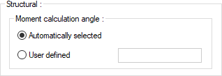

Moment calculation angle
In automatic selection, it is the preferred option in most cases. However, in special systems, give the account angle at the desired value.

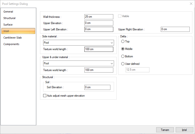

Wall Tab
Wall thickness
Give the thickness of the pool wall whose properties have been changed.
Upper elevation
Give the upper elevation of the pool wall. The height of the pool walls is equal to the pool height. The height of the pool wall will change according to the value entered in the upper elevation value. + or - can be given a value.
Upper left elevation
With the value entered here, it changes the height of the upper left corner of the pool wall. Give a suitable value according to your system. For example, if you give the upper left elevation of a 200 cm high wall as 25, you would define a wall with a constant slope from 200 to 225. To change the bottom slope of the pool, you can use the command "edit pool surface slope".
Upper right elevation
With the value entered here, it changes the height of the upper right corner of the pool wall. Give a suitable value according to your system. For example, if you give the upper right level of a 200 cm high wall 25, you would define a wall with a constant slope with a base going from 200 to 225. To change the bottom slope of the pool, you can use the command "set pool surface slope".
Side material
For the solid model, select the material (texture) of the side surfaces of the pool wall from the drop-down list.
Upper & under material
For the solid model, select the materials (textures) of the top and bottom surfaces of the pool wall from the drop-down list.
Soil
It is the elevation that determines the height of the soil on the side where the pool wall touches the ground.

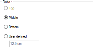

Delta
Give the pool wall off the plan. The position of the wall in the plan will change according to the value entered in the top, middle bottom and any definition.

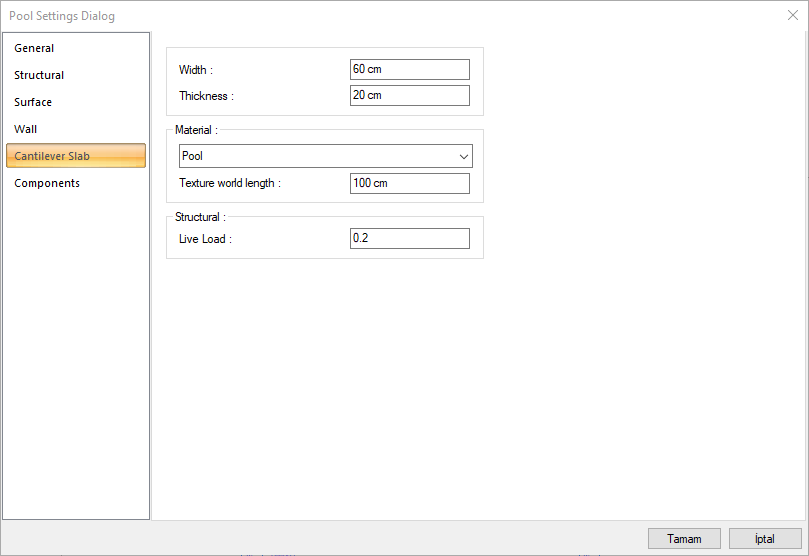

Cantilever Slab Tab
Width
It is the width value of the pool cantilever slab.
Thickness
It is the thickness of the pool cantilever slab.
For the solid model, select the material (texture) of the cantilever slabs from the drop-down list.
Live load
It is the live load value to be taken into account in the pool cantilever slab.

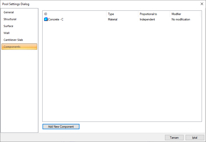

Components Tab
Add Building Components : Assigns the building materials defined for detailed building components metrics to the object.
