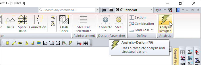

Click the Analysis + Design icon in the ribbon menu for the operation, press the F9 key on the keyboard.

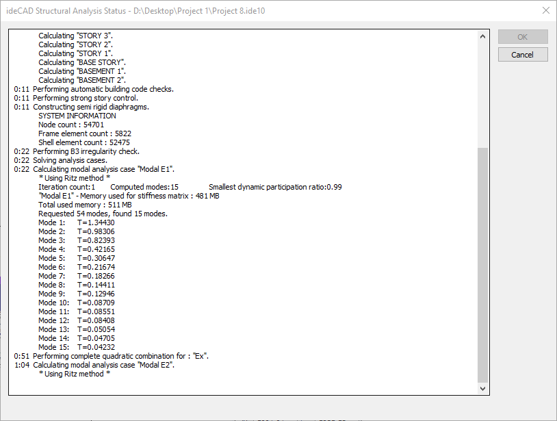

When the OK button is clicked, the analysis + design process will start.
In the analysis status window, the steps and process times applied during the analysis + design process are given for information purposes.
