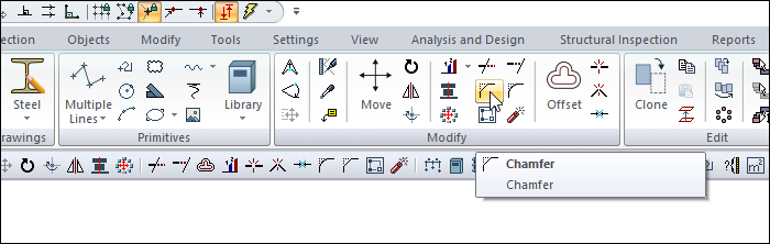

Location of the Chamfer Command
You can access the Chamfer command under the Modify title of the ribbon menu Drawings tab .

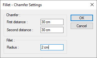

Fillet - Chamfer Settings
Chamfer
The 1st distance determines how much the first line selected will shorten from the intersection point during the chamfer operation.
The second distance determines how much the selected second line will shorten from the intersection point.
Fillet
Radius determines the radius of the arc to be used in the join.
