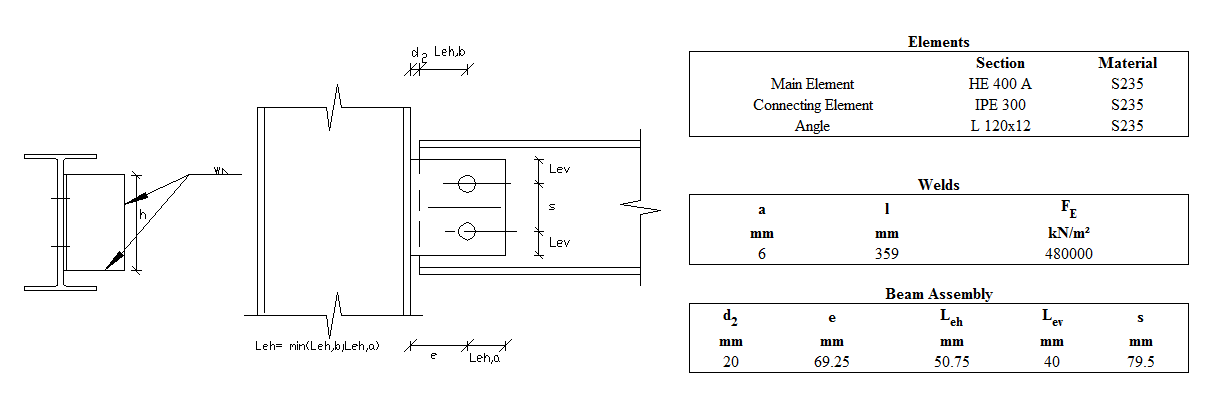

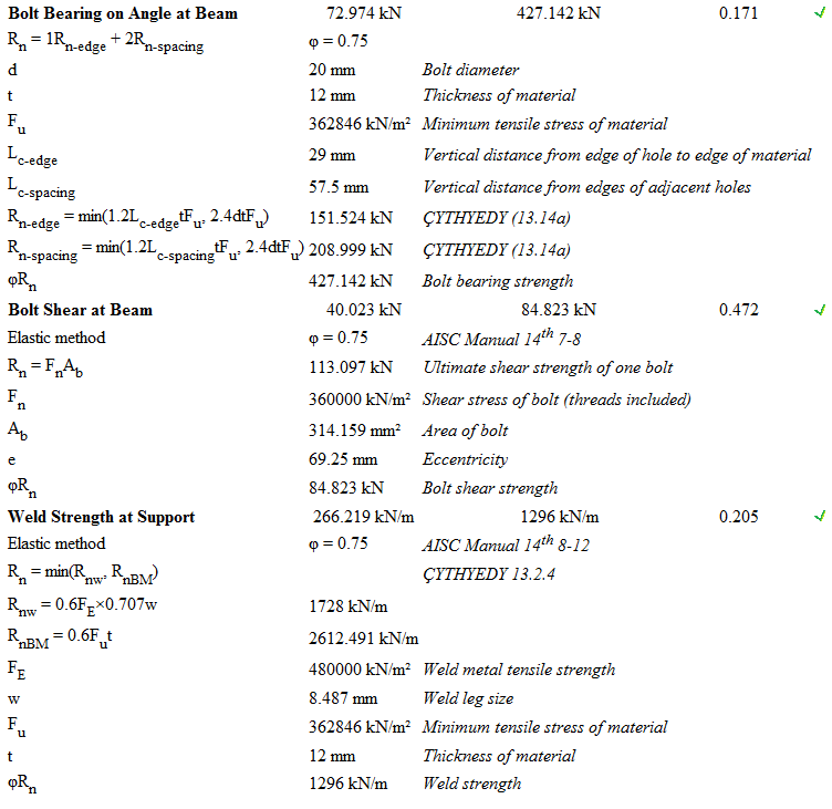

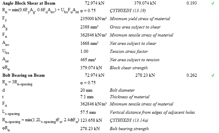

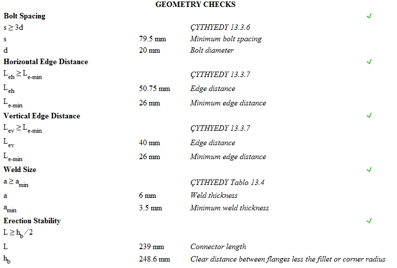

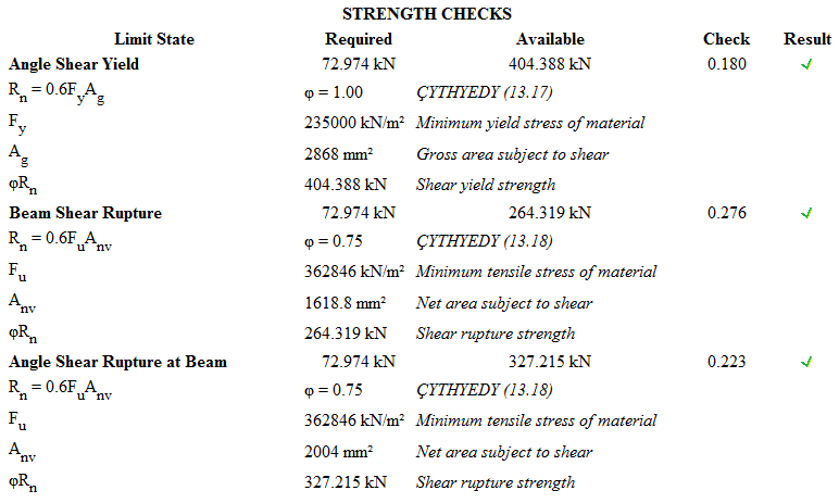

Single Angle Connection Report
In the single angle connection report, the controls of the connection designed according to the Design, Calculation and Construction Principles of Steel Structures (ÇYTHYEDY) (GKT and YDKT) or AISC 360-16 (ASD and LRFD) regulations are given.
