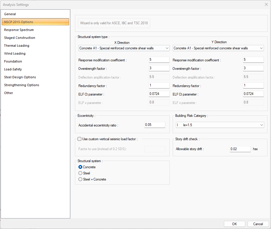

Analysis settings that vary depending on the NSCP 2015 are explained in detail.
NSCP 2015 Options Tab in ideCAD Structural
Structural system type per NSCP 2015
The type of structural system for the X and Y directions is selected according to the building's design.
Response modification coefficient per NSCP 2015
It is the response modification coefficient value. This row is automatically refreshed when the structural system type is chosen.
Overstrength factor per NSCP 2015
It is the strength excess coefficient value. This row is automatically refreshed when the structural system type is chosen.
Redundancy factor per NSCP 2015
It is the redundancy factor value. This row is automatically refreshed when the structural system type is chosen.
ELF Ct parameter per NSCP 2015
It is the ELF Ct parameter. This row is automatically refreshed when the structural system type is chosen.
Accidental eccentricity ratio per NSCP 2015
The eccentricity ratio used during the analysis is given as a percentage.
Use custom vertical seismic load factor per NSCP 2015
If checked, the custom vertical seismic load factor, which is entered in the "factor to use (instead of 0.2 SDS)" line, is used.
Structural system per NSCP 2015
If the building block consists of only concrete elements, Concrete; if it consists of only steel elements, Steel; Steel + Concrete option is selected if it consists of concrete and steel elements.
Building Risk Category per NSCP 2015
Building risk category value is selected from the list according to the purpose of use of the building.
Story drift check per NSCP 2015
Allowable story drift value is entered.

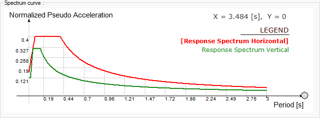

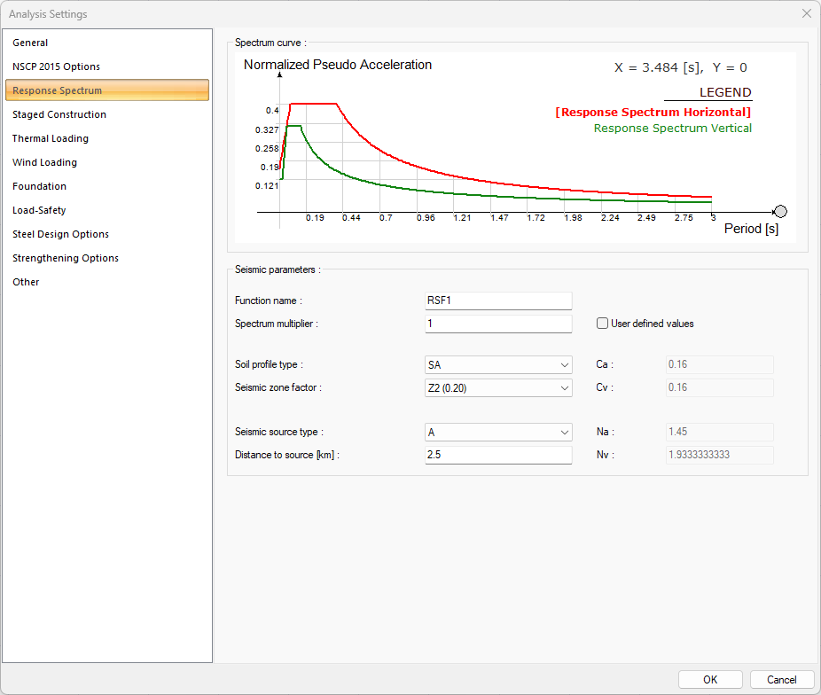

Response Spectrum Tab in ideCAD Structural for NSCP 2015
Spectrum curve per NSCP 2015
The spectrum curve resulting from the settings is shown.
Function name per NSCP 2015
The name of the spectrum function.
Spectrum multiplier per NSCP 2015
Factor of spectrum function.
Soil profile type per NSCP 2015
Soil profile type is selected for the response spectrum.
Seismic zone factor per NSCP 2015
The seismic zone factor value is entered for the response spectrum.
Seismic source type per NSCP 2015
The seismic source type is selected for the response spectrum.
Distance to source [km] per NSCP 2015
Distance to source value is entered for the response spectrum.
User-defined values per NSCP 2015
If this option is selected, parameters such as Ca, Cv, Na and Nv become active.
Ca/Cv per NSCP 2015
The seismic coefficient value is entered for the response spectrum.
Na per NSCP 2015
Near source factor use in the detemination of Ca for the response spectrum.
Nv per NSCP 2015
Near source factor use in the detemination of Cv for the response spectrum.
