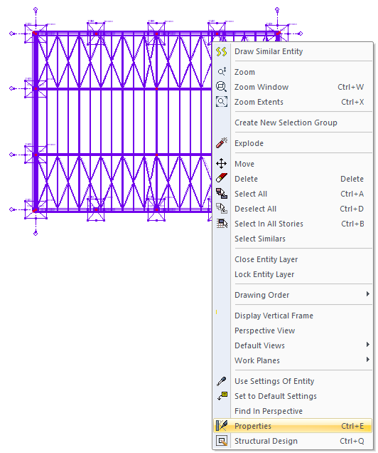

Select the hall where you want to change the roof height and click the right mouse button. Click the Properties line from the right click menu that opens.

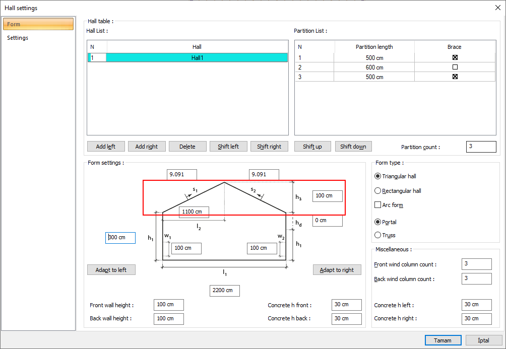

  • Enter the hall settings.

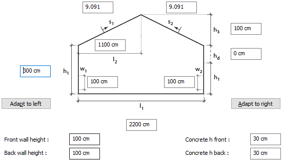

  • Enter the new height value in the h3 box.
  • Roof height will change according to the value you entered.

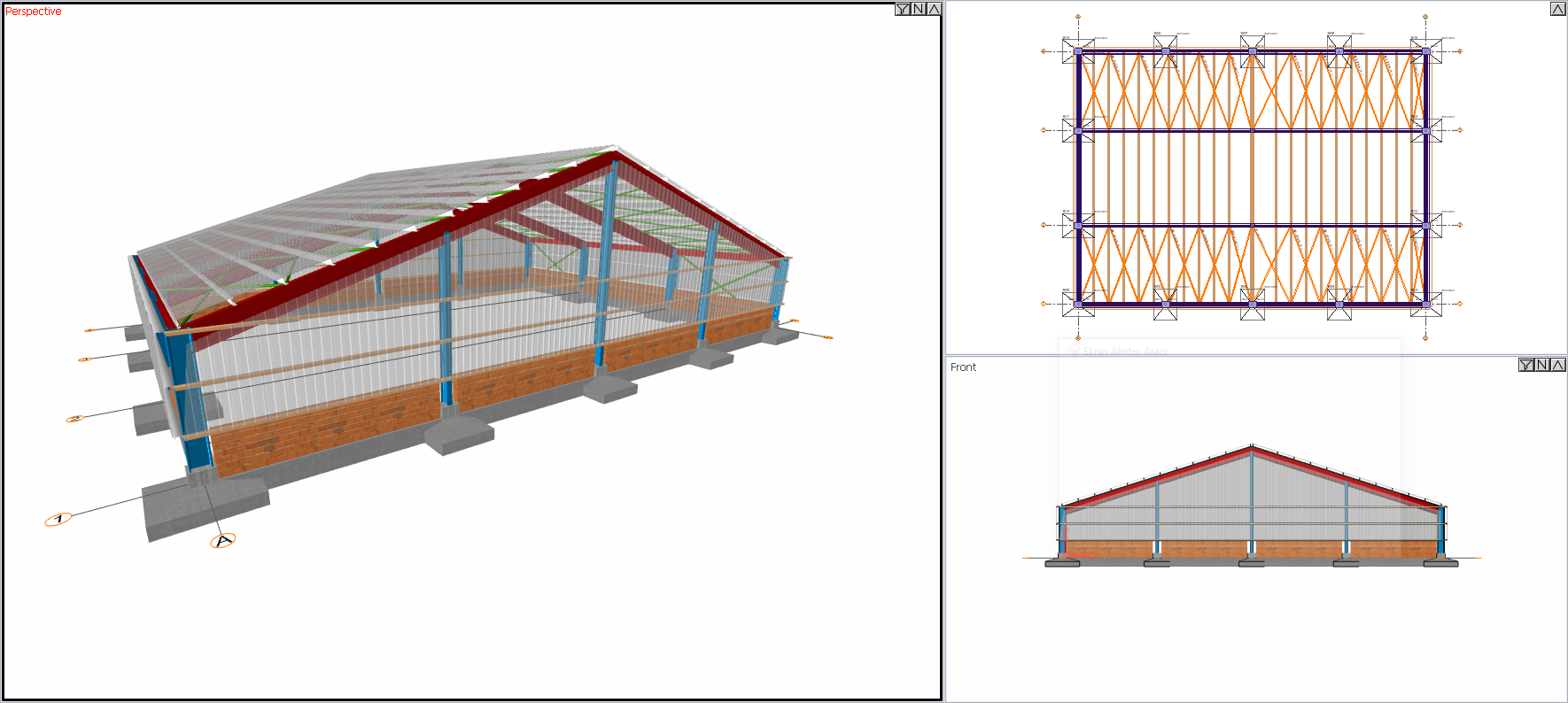

Hall view before changing the roof height
Settings

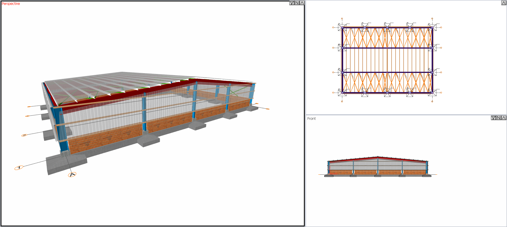

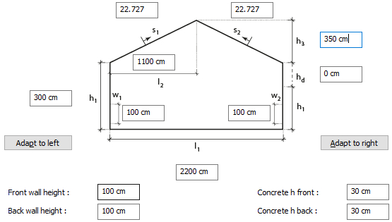

Hall view after h3 is changed to 350 cm
Settings
