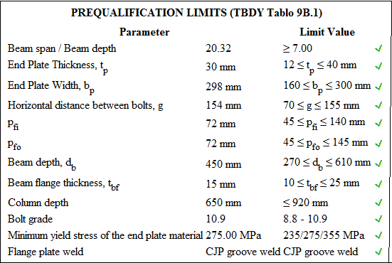

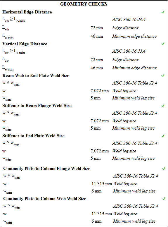

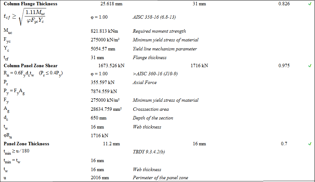

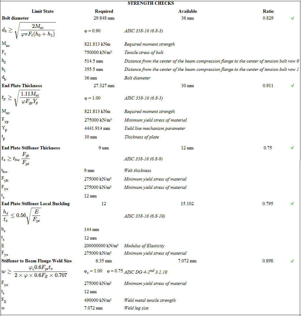

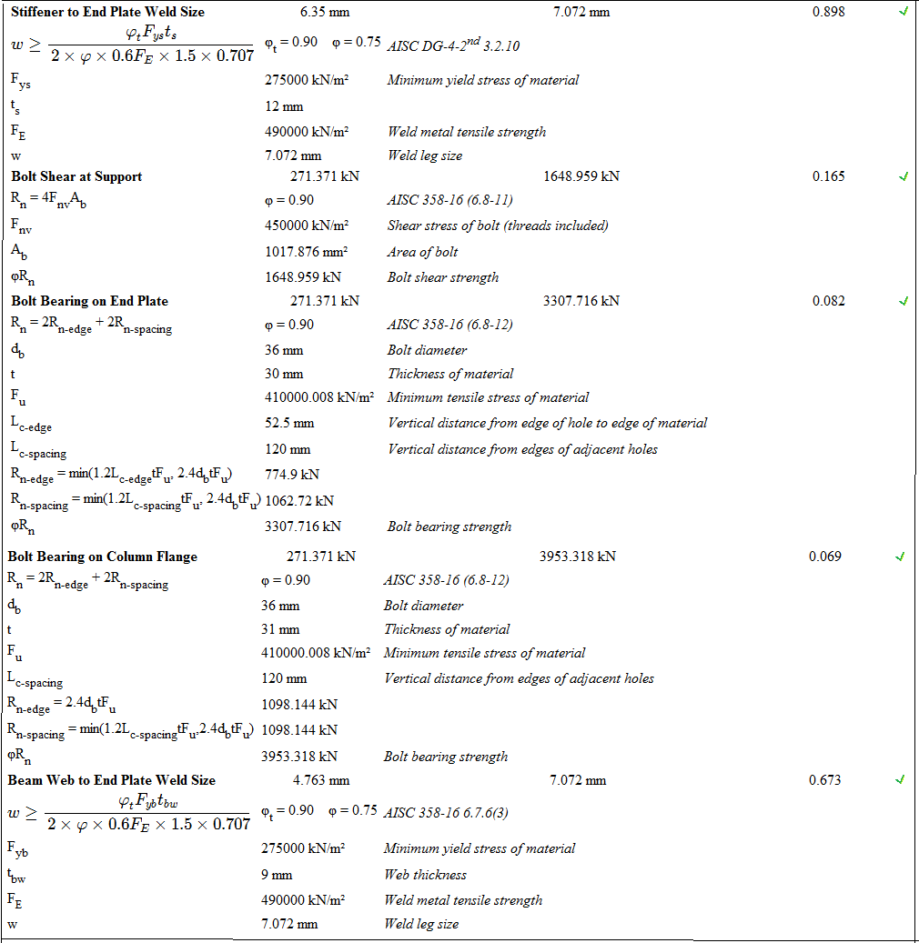

A sample of four bolts stiffened end plate connection report according to AISC 358-16 & AISC 360-16 is given below.
  • Four bolts stiffened end plate connection is designed automatically according to the AISC 358-16 & AISC 360-16 by the ideCAD Structural.
