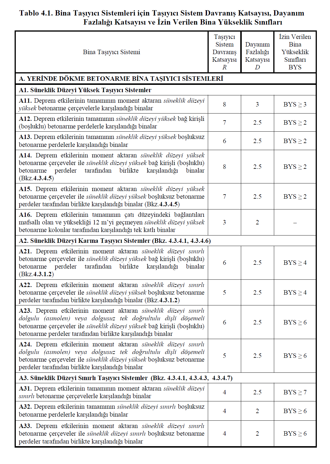

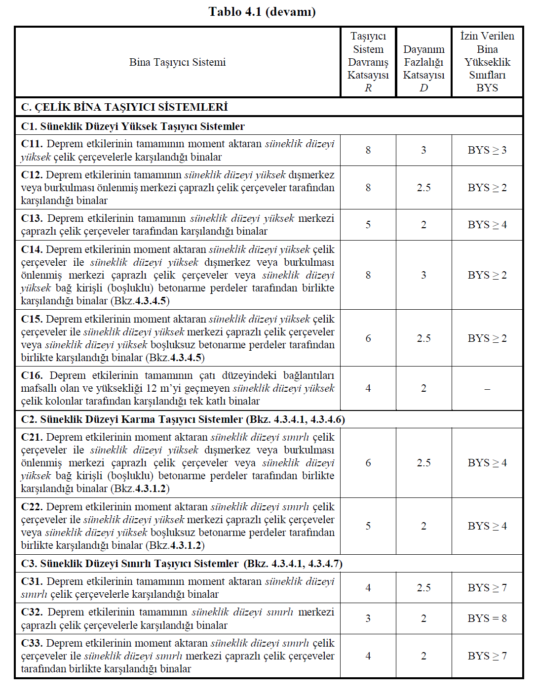

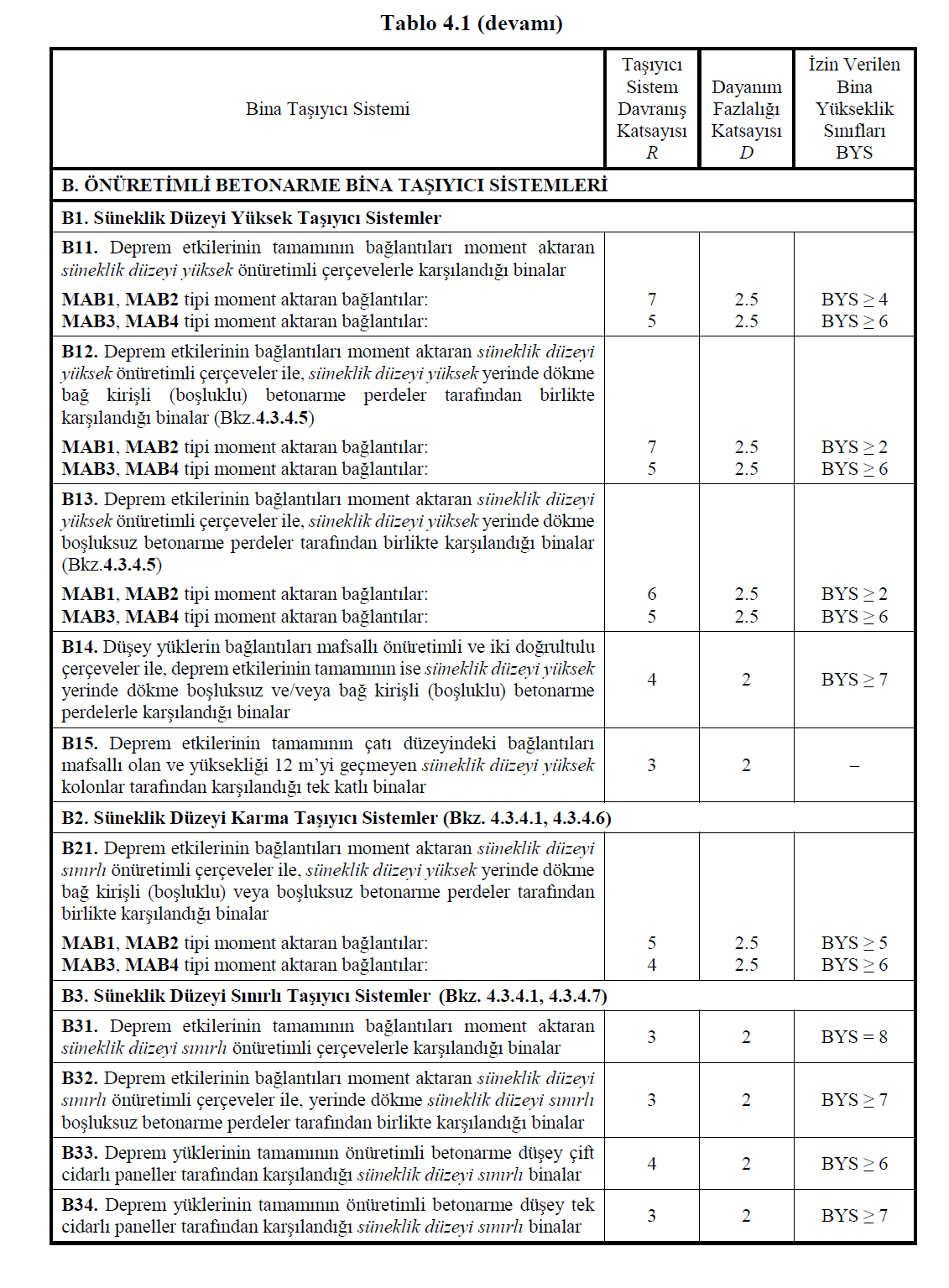

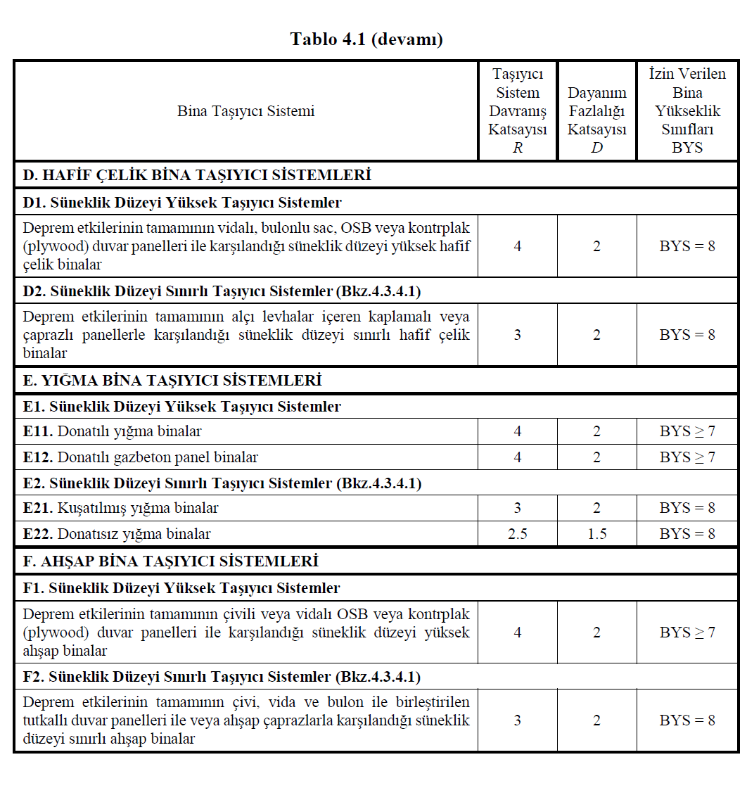

4.3.2. R and D Coefficients According to Carrier System Type
4.3.2.1 - Cast in-situ and precast concrete, steel, mild steel, masonry, wood building structural systems and 4.3.3 't defined for various ductility Annex 4 , as defined in the Structural Behavior Factor R and Resistance Redundancy Factor D Table 4.1 ' is also given.
4.3.2.2 - In composite column systems, R and D coefficients given for steel structural systems shall be used.
According to the definition given in 4.3.2.3 - 3.3.1 , in buildings with externally rigid walls surrounded by basements, (R / I) = 2.5 and D = 1.5 in the lower part of the basement floors.
4.3.2.4 - If one of the two conditions defined in (a) and (b) below cannot be met in any direction, in buildings with reinforced concrete curtain walls and / or steel braced frames with DTS = 1, 1a, 2, 2a, the Structural System Behavior Coefficient in that direction Instead of R , (4/5) R will be considered. No change will be made in the Strength Excess Coefficient D. The tie-beam curtain system satisfying the conditions given in 4.5.4.5 will be considered as a single curtain.
(a) In the structural system, the base overturning moment M DEV taken by a single wall or steel braced frame shall not be more than 1/3 of the total base overturning moment M o resulting from the earthquake loads for the whole building in that direction .
(b) Construction each side axles located screen / screen or steel braced frame / receives base overturning moment of the frames M DEV or M DEV 'the sum of all, that the direction in total floor tilting moment occurring in seismic loads for the entire building M o ' s 1 It will not be less than / 6.
