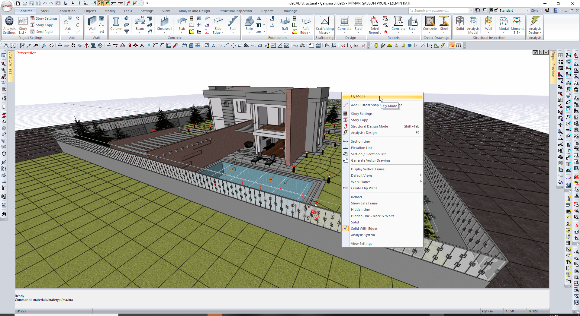

Click the right mouse button on the active perspective window.
  • Click the "Fly Mode" line from the menu that opens.

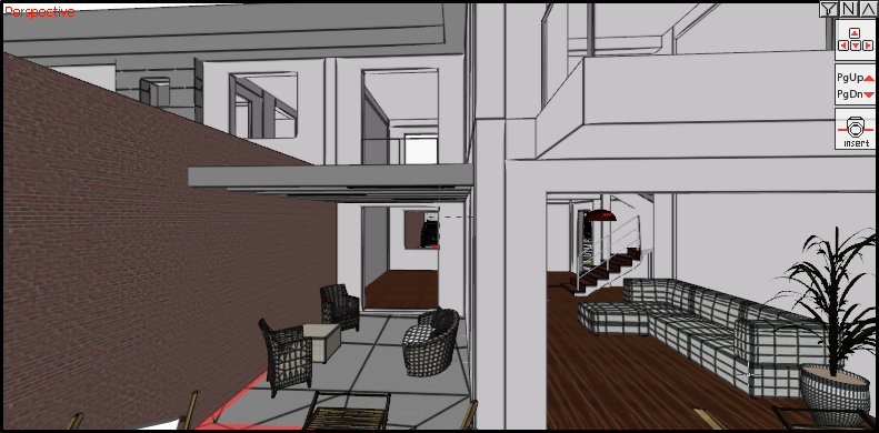

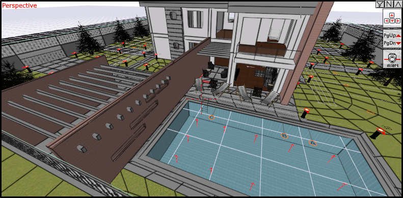

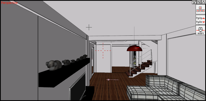

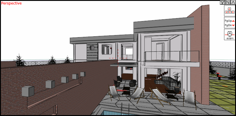

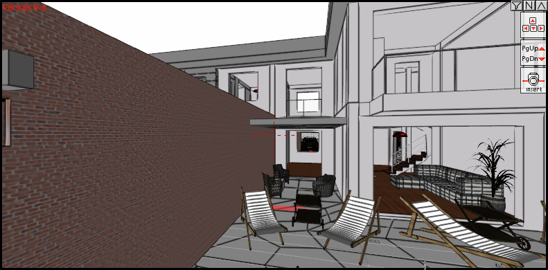

The flight mode steps are shown in the screenshots below. The building is approached from outside to inside.
