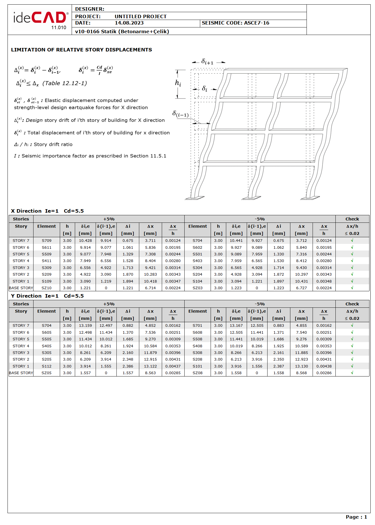

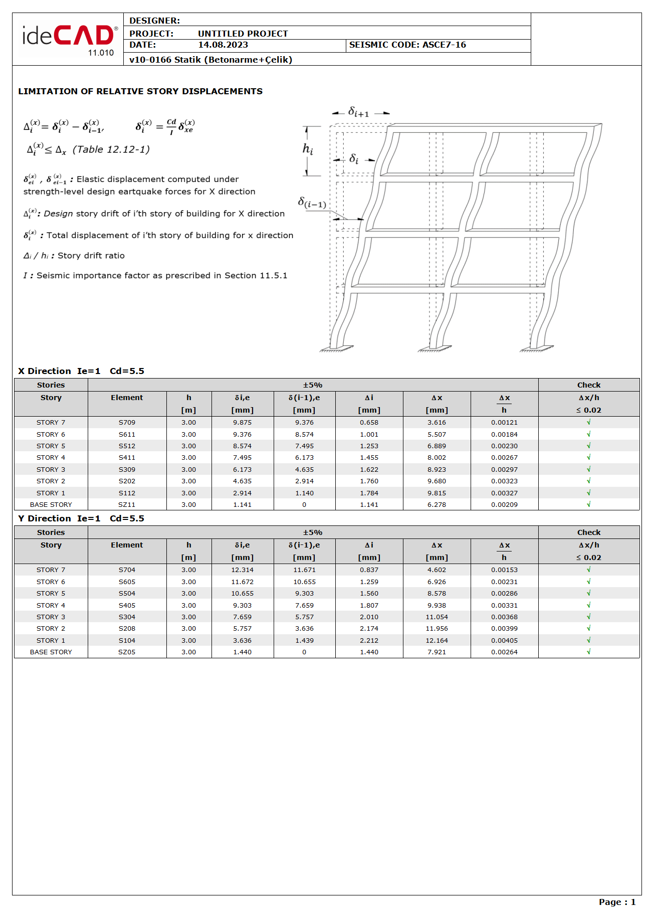

  • Story drifts are controlled and reported in the seismic report.
The story drifts control report section in the Earthquake Regulation report includes the value calculated for the '+' and '-' 5% extra eccentricity in X and Y directions for each floor and the comparison with the limit value.
