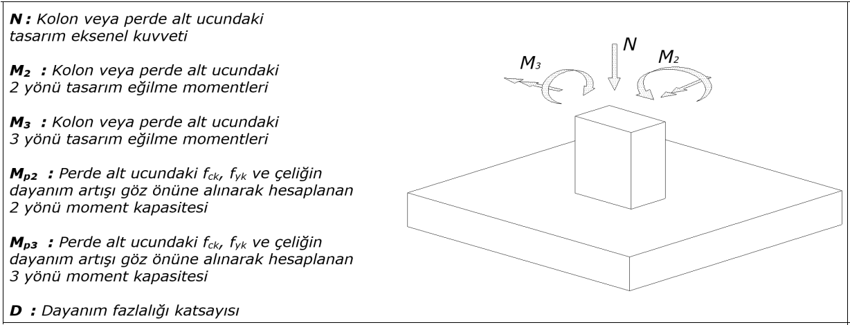

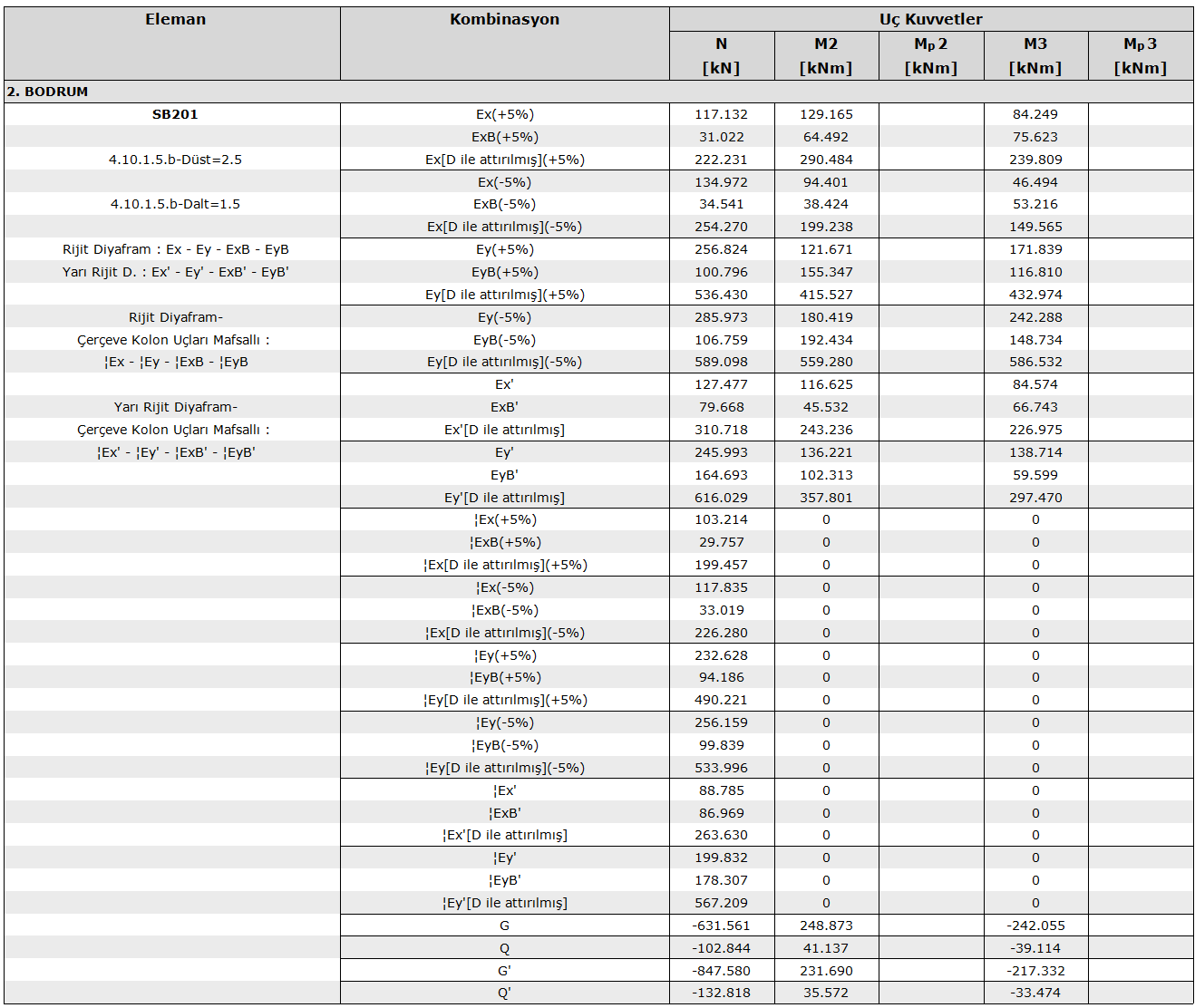

  • Determination of Internal Forces Acting on Foundations (4.10.3) section explains the calculation of the forces transferred to the foundation in accordance with TBDY 2018 in case of a non-interacting superstructure solution.
  • The superstructure interactive solution was used for this building. Required increases for basement floor elements in structures with basements are also explained in the above-mentioned article.

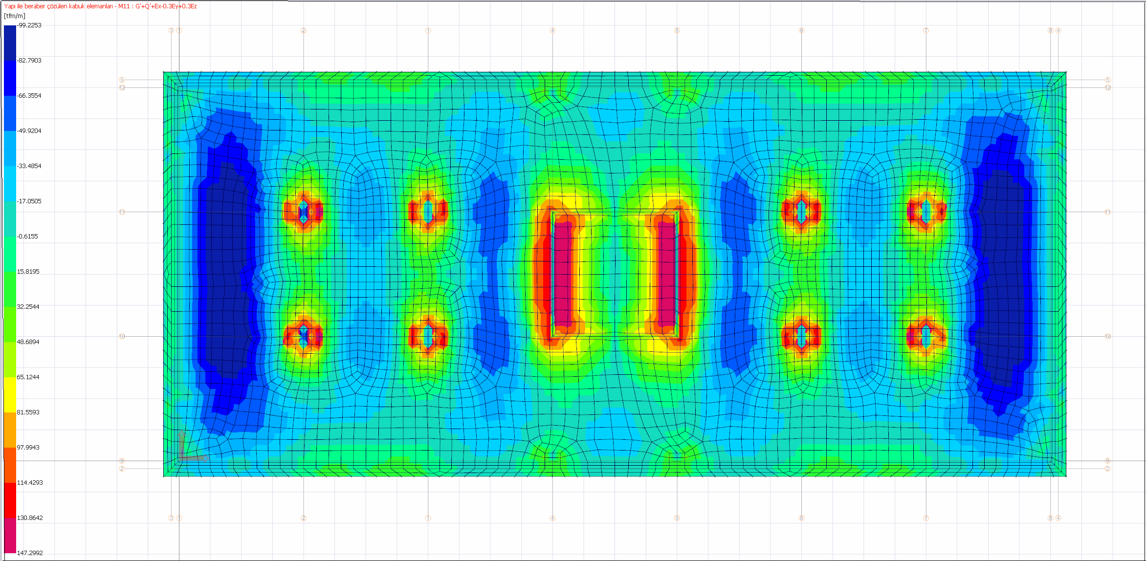

  • The stresses occurring at the foundation are controlled from the program screen.
