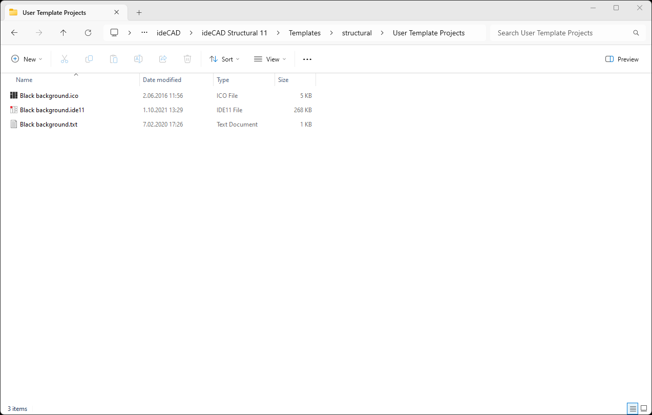

Templates are stored under the Template folder of the ideCAD installation folder.
Under the Template/structural folder, there is the default project files and the User Template Projects folder created by the ideCAD during program installation.
You can save a new project as a template in the user template projects folder. If you want , you can open other folders within the Template/structural folder to classify the templates.

  • The Save project dialog will open. In this dialog navigate to the Template/structural folder located under the ideCAD folder .
  • Double-click the user template projects folder, or if you have created before, double-click the folder you created.
  • Give a name to the file name section. Click the OK button. Template project will be created.

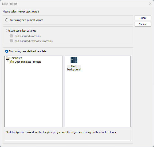

  • If desired, a description text and icon of the template project can also be created. An icon (.ico) file is created with a .txt file with the same name as the template file and copied to the folder where the template file is located.
  • When you click the ideCAD icon/New icon in the ribbon menu , you can start drawing by selecting your saved template in the New Project dialog.
