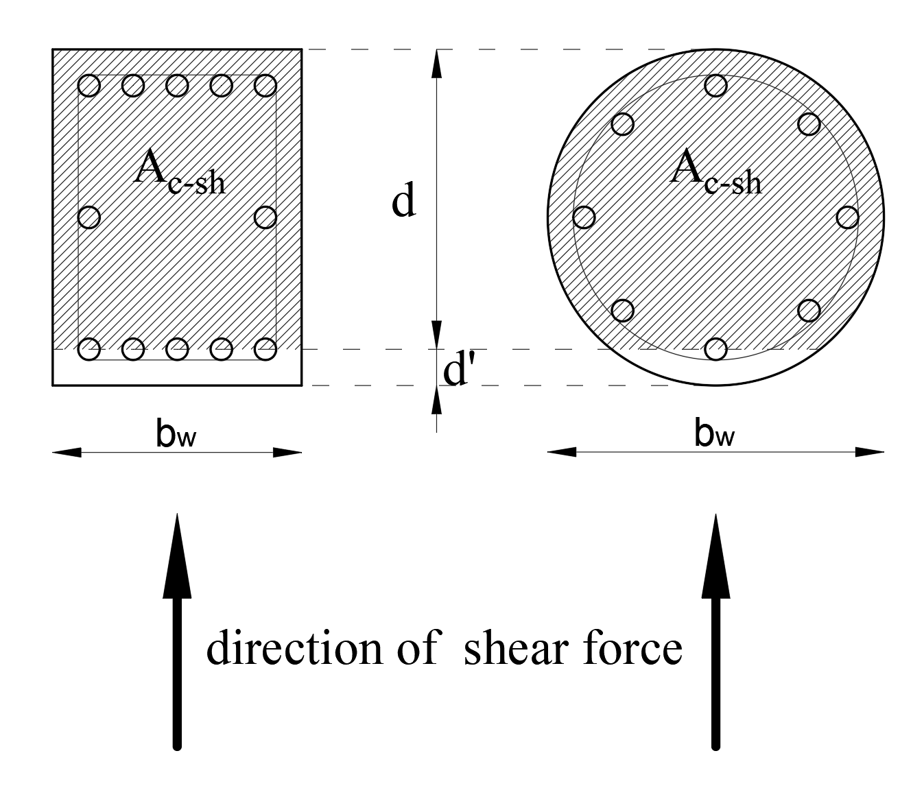

For calculation of Vc, Vs, or ACI Eq. (22.5.1.2), d is taken as the distance from extreme compression fiber to centroid of longitudinal tension reinforcement. In ACI Eq. (22.5.1.2) the product of bwd is equal to the shear area Ac-sh for rectangular sections. However, in solid, circular sections, the shear area Ac-sh should be found as shown in the picture below. According to ACI 22.5.2.2, d is allowed to be taken as 0.8 times the diameter, bw (d = 0.8bw).
