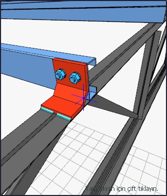

With the Purlin Connection command, purlin-truss or purlin-steel beam connections are defined. When purlins are defined, their connection is automatically defined. The automatically defined connection can be deleted and a new one can be made.

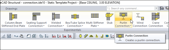

Location of the Purlin Connection Command
  • From the Connection menu, click the Purlin Connection icon.
  • Click the beam or truss, then the beam, respectively, from the 3D perspective view.

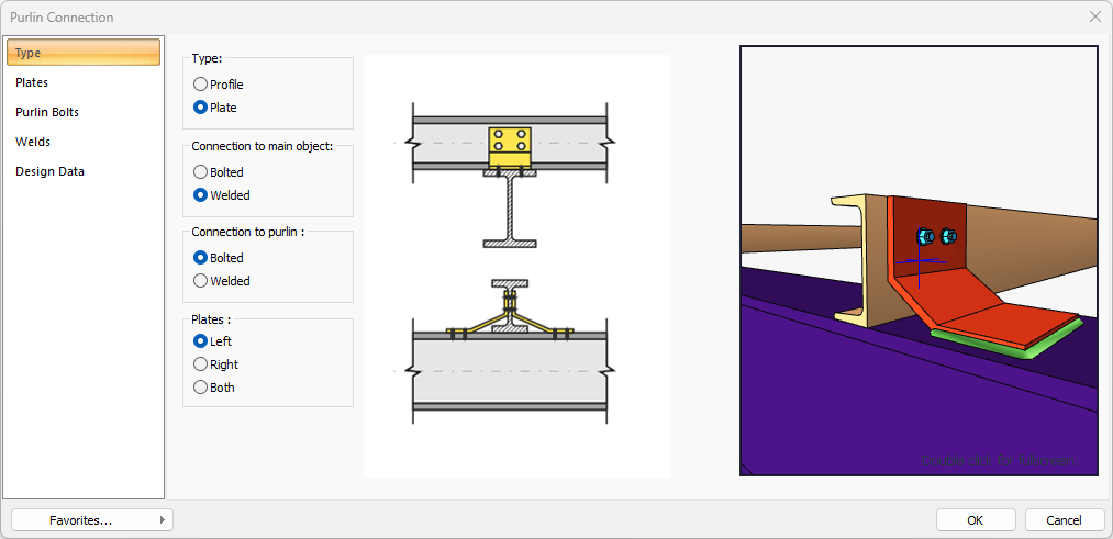

Type Tab
Type
Profile or plate type is selected.
Connection to main object
Welded or bolted connection type is selected for connection to the main object.
Connection to purlin
Welded or bolted connection type is selected for connection to the purlin.
Plates
It is chosen whether the plates will be on the left or right or on both sides.

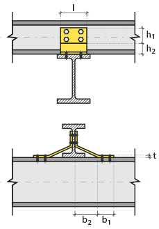

Connection is shown on the schematic drawing.

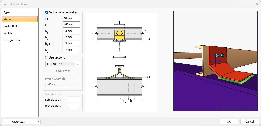

Plates Tab
This tab appears when the plate is marked in type tab..
Define plate geometry
If the option is selected, it is determined by entering the angle values. The values ​​to be entered are shown in the schematic drawing.
Use section
By selecting the option, one of the ready-made L profiles is selected from the list as an angle bracket. By clicking on the Load section button, you can reach the ready section library and reach the list of American and European finished rolling sections and select from the list.
Profile length
Profile length value is entered.
Side plates
By entering values, left and right side plates are defined.

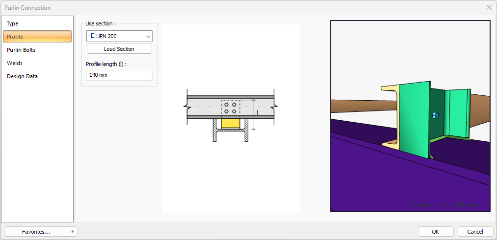

Profile Tab
This tab appears when the profile is marked in type tab..
Use section
By selecting the option, one of the ready-made U profiles is selected from the list as a profile. By clicking on the Load section button, you can reach the ready section library and reach the list of American and European finished rolling sections and select from the list.
Profile length

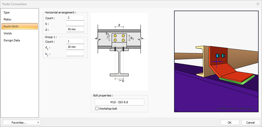

Purlin Bolts Tab
Horizontal arrangement
Group 1
Bolt properties

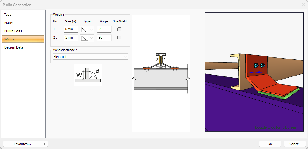

Welds Tab

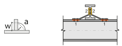

Welds
Weld electrode

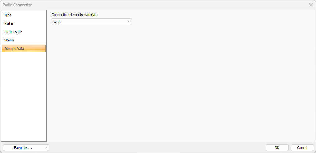

Design Data Tab
