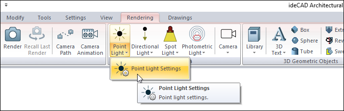

Location Point Light Settings Command
You can access it under the ribbon menu Rendering tab, Light - Camera title.

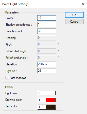

Power

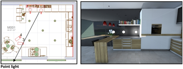

A measure of the light flux emitted from a light source in a unit solid angle. It is also referred to as amplitude, perceived by the human eye as brightness.
The point light source intensity is defined as 2 in the 2nd object and 5 in the 3rd object.
Shadow smoothness
Increasing the softness of the shadow allows to adjust the transition tone between light receiving and non-receiving surfaces.
Sample count
Indicates at how many points the light will be calculated. It affects the quality of the edges of soft shadows.
Elevation
The vertical position of the light source on the story plan is determined. The elevation where the light source will be at a height of m / cm or mm from the ground is defined.
Light no
It can be named with the number given to the light source.
Cast shadows
When the option is checked, shadows caused by the light source are shown.
Light color
The color of the light is adjusted here. After clicking, the desired color is selected from the color palette displayed on the screen.
Drawing color
Changes the color of the light source drawing in the plan. After clicking, the desired color is selected from the color palette displayed on the screen.
Text color
Changes the color in the plan expressing the name or number of the light source. After clicking, the desired color is selected from the color palette displayed on the screen.
