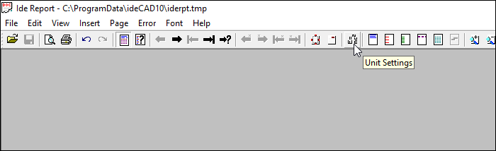

Location of Unit Settings Command
  • Get a report.
  • The program will open the ideCAD Report program.
  • Click the Unit Settings icon from the toolbar in the report program .

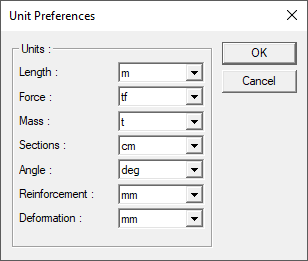

  • The unit options dialog will be displayed.
  • Set the units according to the preferences in the list.
Unit Preferences
Length
Unit is selected for length values.
Force
Unit is selected for force values.
Mass
Unit is selected for mass values.
Sections
Unit is selected for area values.
Angle
The unit is selected for angle values.
Reinforcement
Unit is selected for reinforcement values.
Deformation
The unit is selected for the deformation values.
