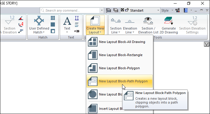

Location of New Layout Block- Path Polygon Command
You can access it under the Ribbon menu drawings tab, Layout Design title.
  • Click the New Layout Block - Path Polygon icon.

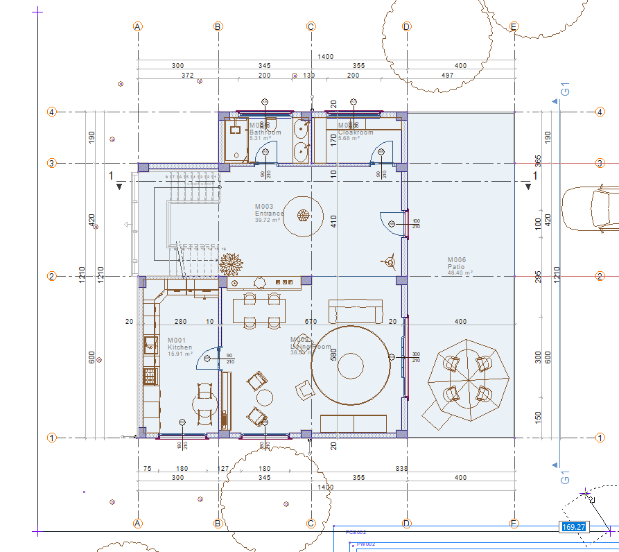

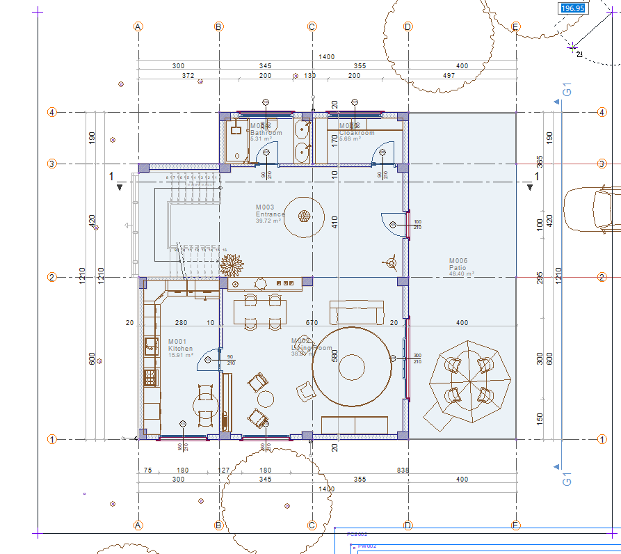

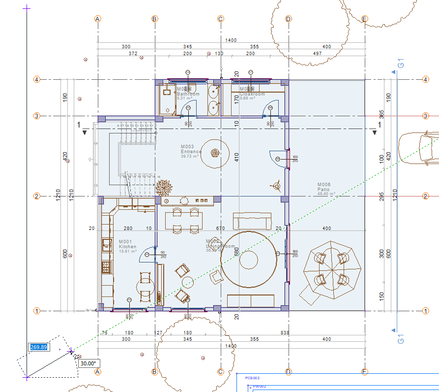

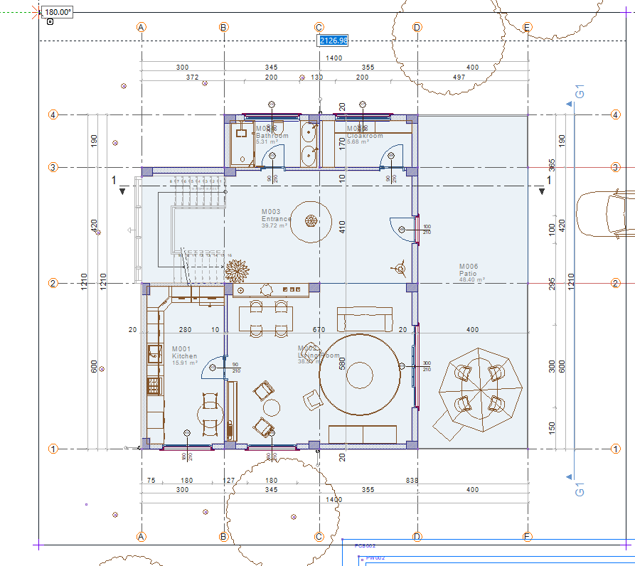

  • Move the mouse by clicking one of the corner of the area you want to block in the drawing area. Click the other points respectively. When you click the first point again, the polygon will be complete.
  • Click any point in the drawing area. The point you click will be the insertion point of the block.
  • The Layout Block Settings dialog will open. In this dialog, give a block name and set the scale.
  • If you want to indicate the perimeter of the block with a line, check the Draw border line.
  • If you leave the Save to library line checked, the block will be saved in the archive.
  • Click the OK button.
Determining the first point for the block border

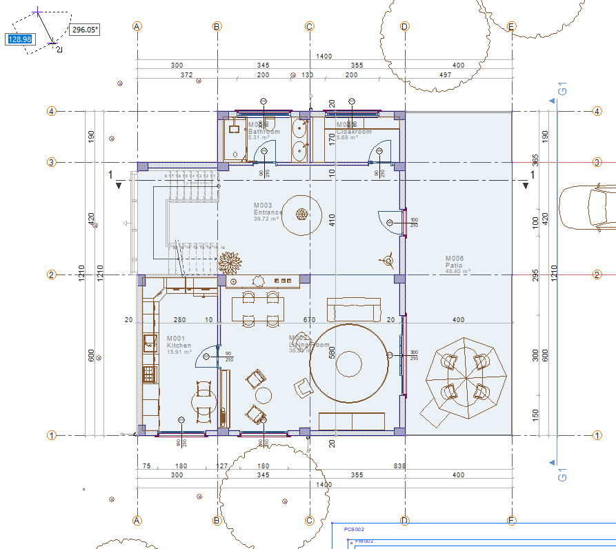

Determination of the third point
Determination of the fourth point

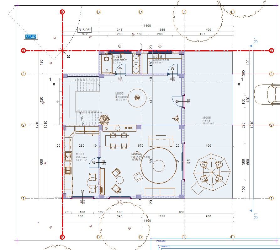

Closing the border by clicking the first point

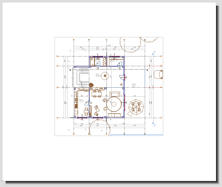

Determination of insertion point
Layout block creation
