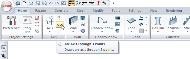

Location of Arc Axis Through 3 Points Command
You can access it under the ribbon menu, Home tab, Axis heading.

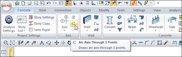

In the Structural Program
You can access it under the ribbon menu, Concrete tab, Axis heading.

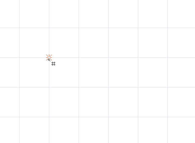

  • Click any point in the drawing area with the left mouse button. This point will be the first end of the arc axis to be drawn.

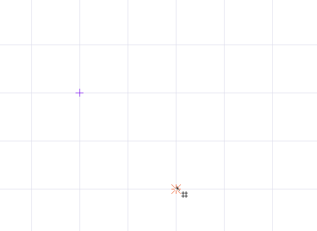

  • Drag the mouse and left click to set a second point. This point will be the second end of the arc axis.

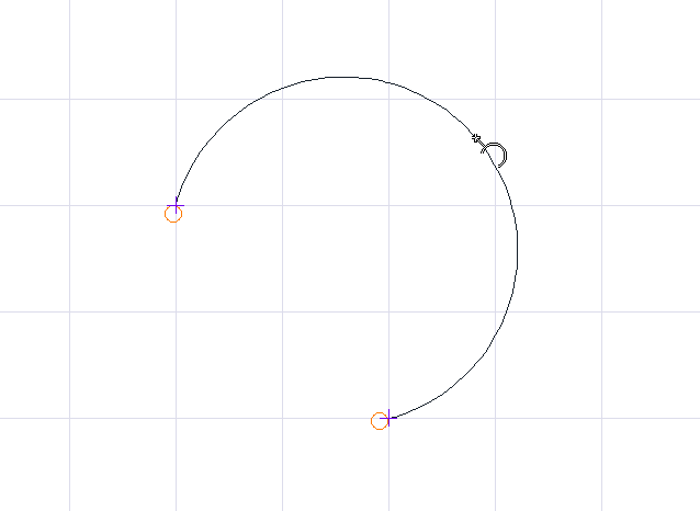

  • When you move the mouse, the arc axis will change shape depending on the mouse.
  • When your arc axis is in the intended location, click the left button.

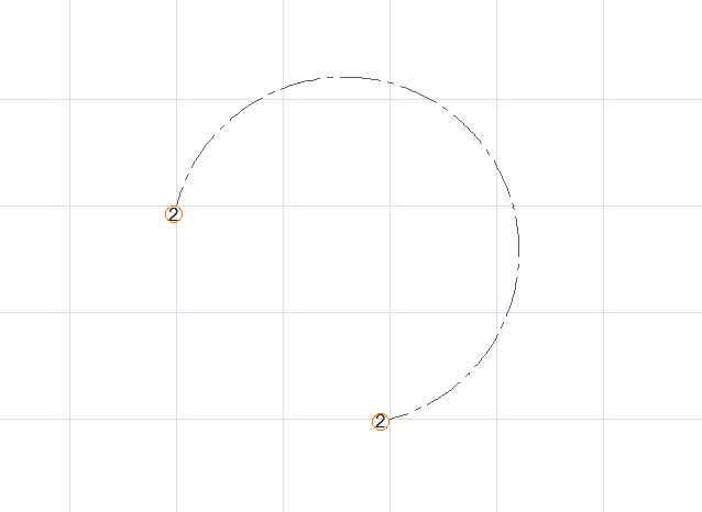

  • Your arc axis will be drawn.
Determination of the first point (start) of the arc axis
Determination of the second point (end) of the arc axis
Determination of the third point (arc angle) of the arc axis
Formation of arc axis through 3 points
