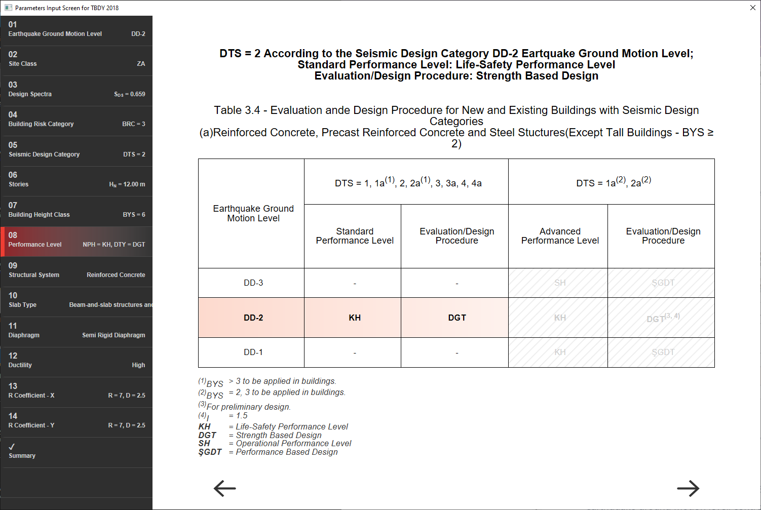

Performance Level
In this step, according to Table 3.4 of TBDY 2018, it is shown that for the DD-2 earthquake ground motion level, controlled damage performance level (KH) is selected as the standard performance level and design according to strength (DGT) is selected as the evaluation/design procedure.
Structural system
