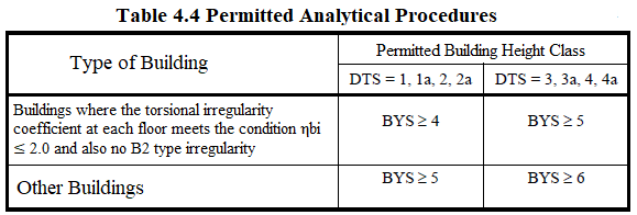

  • In TBDY 2018 Table 4.4, there are conditions related to the buildings where the Equivalent Earthquake Load Method among the Linear Calculation Methods can be applied.

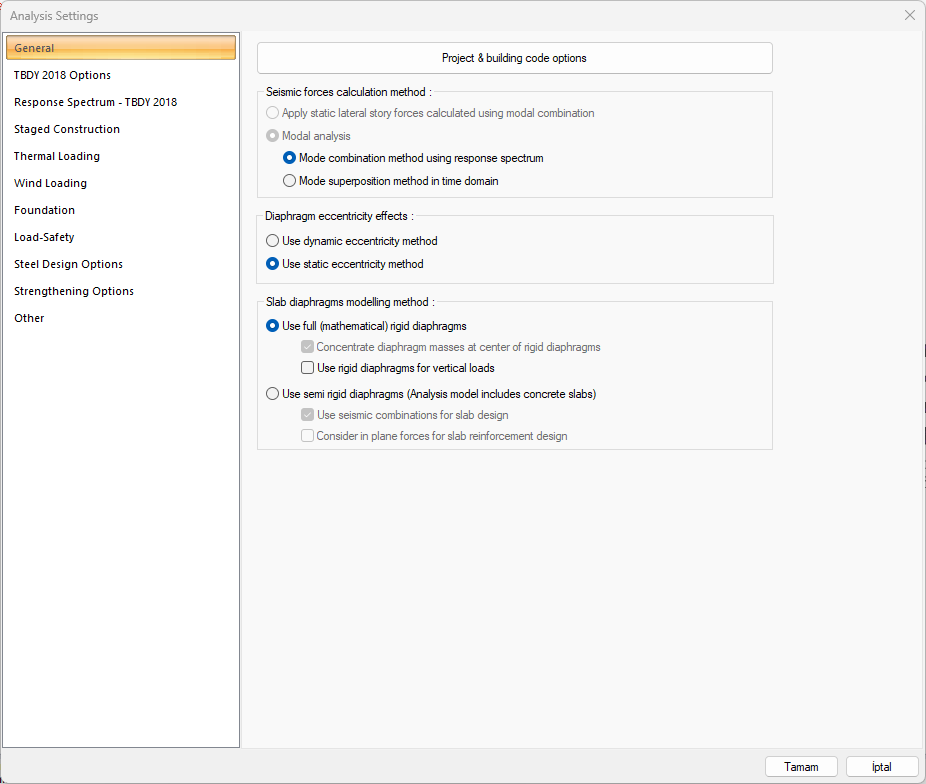

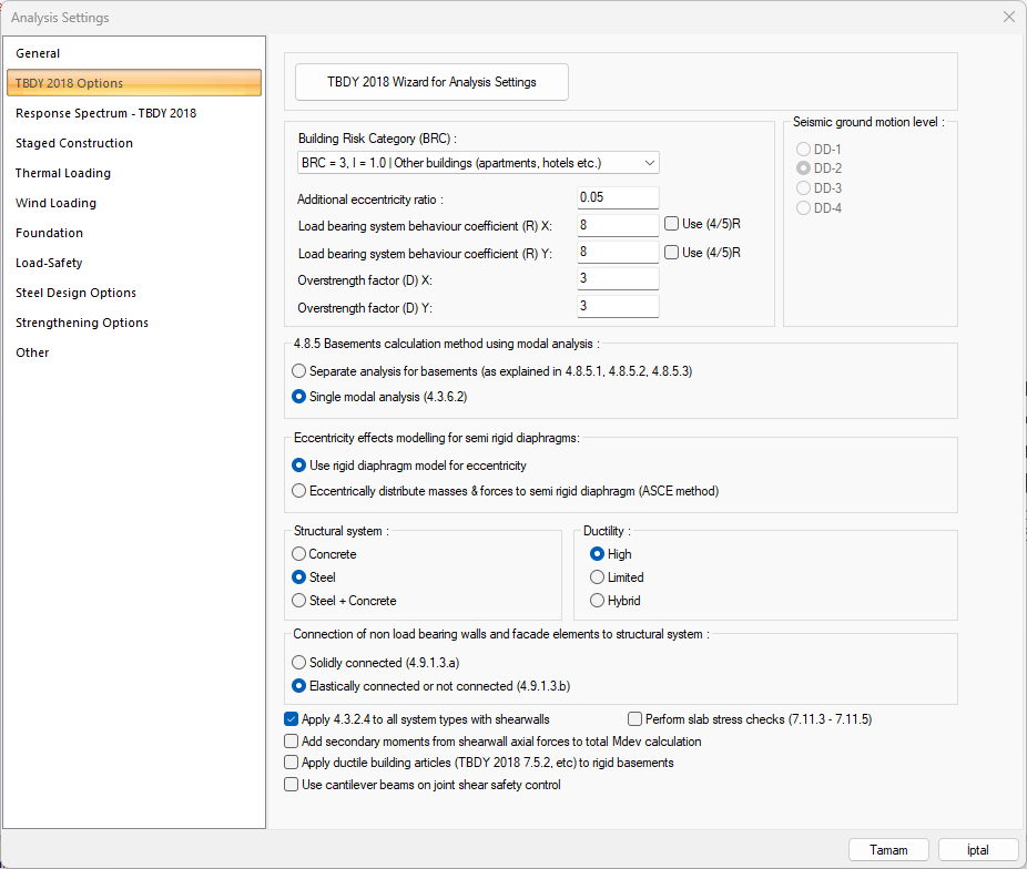

  • Since the building we are designing according to Table 4.4 is BYS=6, the equivalent earthquake load method can be used. The Modal Combination Method, which is inclusive and can be used in all buildings, has been used for design.
