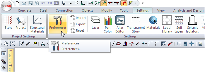

  • Click the Preferences icon in the settings tab in the ribbon menu .

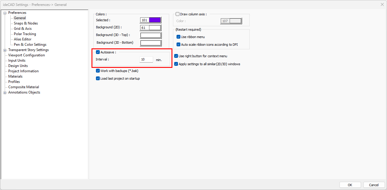

  • Check the Autosave feature in the preferences dialog .

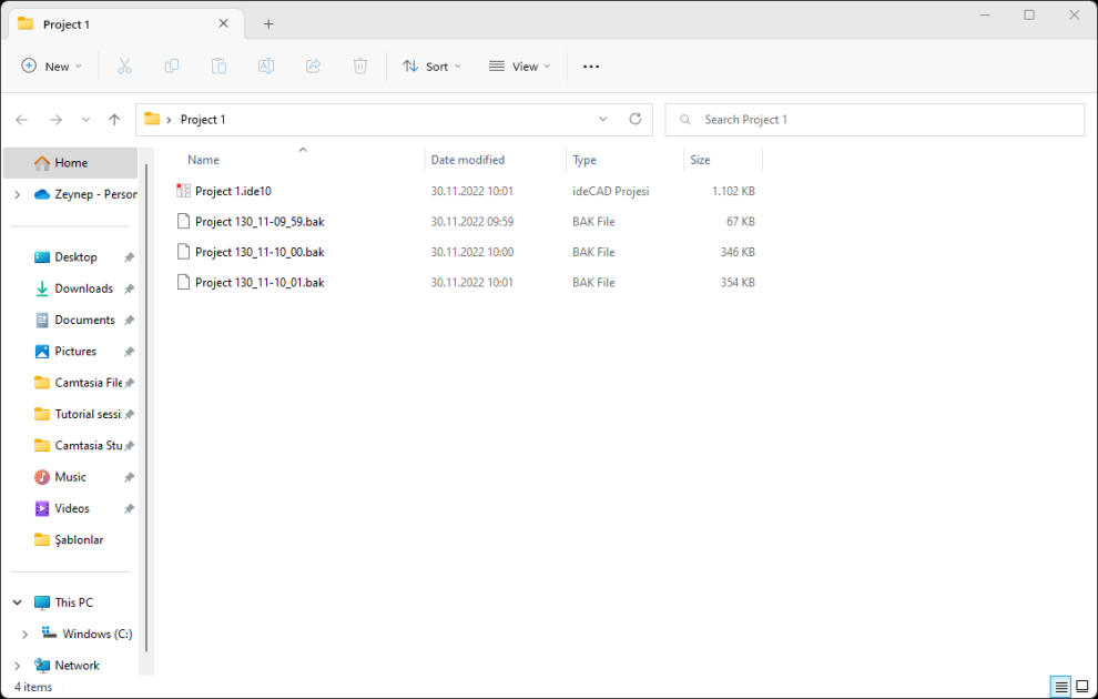

  • If Autosave is active, backups with .bak extension will be created in the folder where your project is registered.
  • If it is not active, check the Autosave line and enter a value in minutes in the interval. Otherwise, backups of your project will not be created.

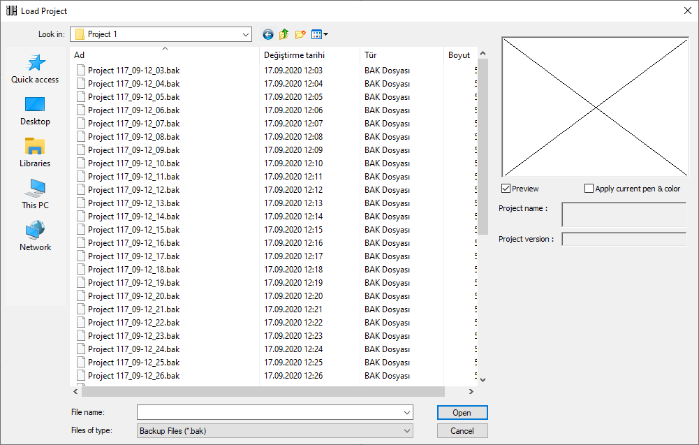

To open project backup files;

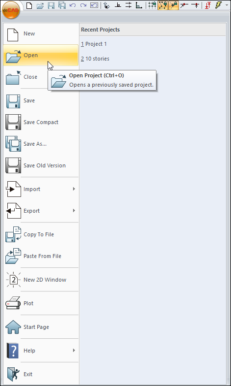

  • Click the Open line from the menu under the ideCAD logo in the upper left corner of the ribbon menu .
  • The Load Project dialog will open.
  • Select "Backup Project Files (* .bak)" from the file type line   .
  • Click the OK button.
  • The backup file will be opened.
