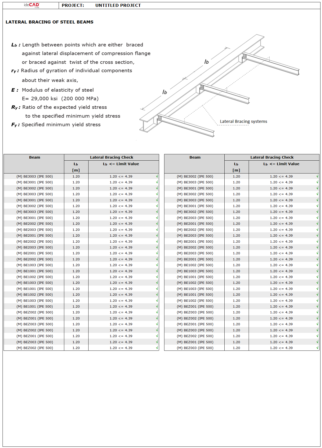

Stability Bracing Control Report for IMF per AISC 341-16 with ideCAD
How does ideCAD control stability bracing for columns and beams according to AISC 341-16?
  • Stability Bracing Control is done automatically and reported by program.
This control is done automatically and reported on the beam members of the moment-resisting steel frame with a moderate ductility level.
