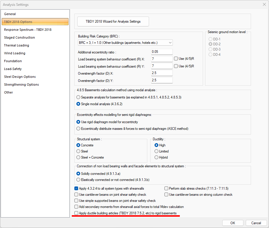

In the Column Beam Joint Shear Capacity report, it appears that the columns in the rigid basement story have not been checked. Why? It is left to user preference in analysis settings. You can see that the option has been checked and checked. Next Topic Can I move all stories of my project at once? Related Topics Analysis Settings Column-Beam Joint Shear Design 15.5.2.5 Column-beam shear safety condition is not provided.
