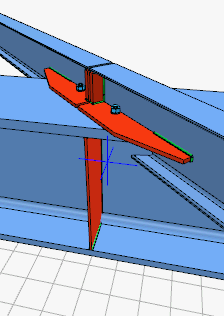

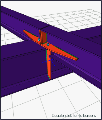

Defining a Notched Seating Connection

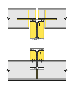

With the Notched Seating Connection command, connection is defined with the number of stiffening plates at different elevations, which is one as one and the other as two pieces of steel element.

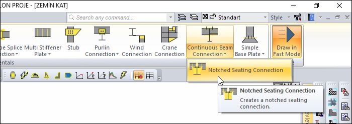

Location of the Notched Seating Connection Command
For two beams whose elevation is different but intersecting;
  • From the Connection menu, click on the Notched Seating Connection icon.
  • First choose the one piece beam. Then select the parts of the other beam in turn.

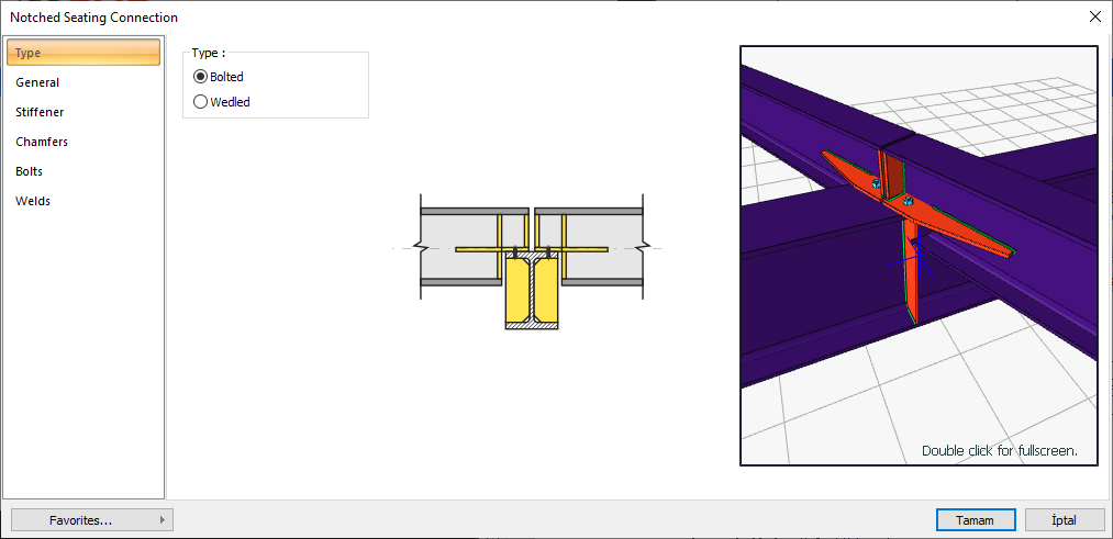

Location of the Notched Seating Connection Settings Dialog
Type Tab
Type
For the connection, one of the bolted or welded connection types is selected.

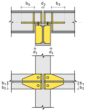

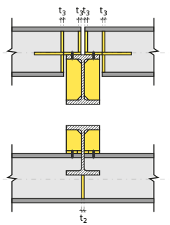

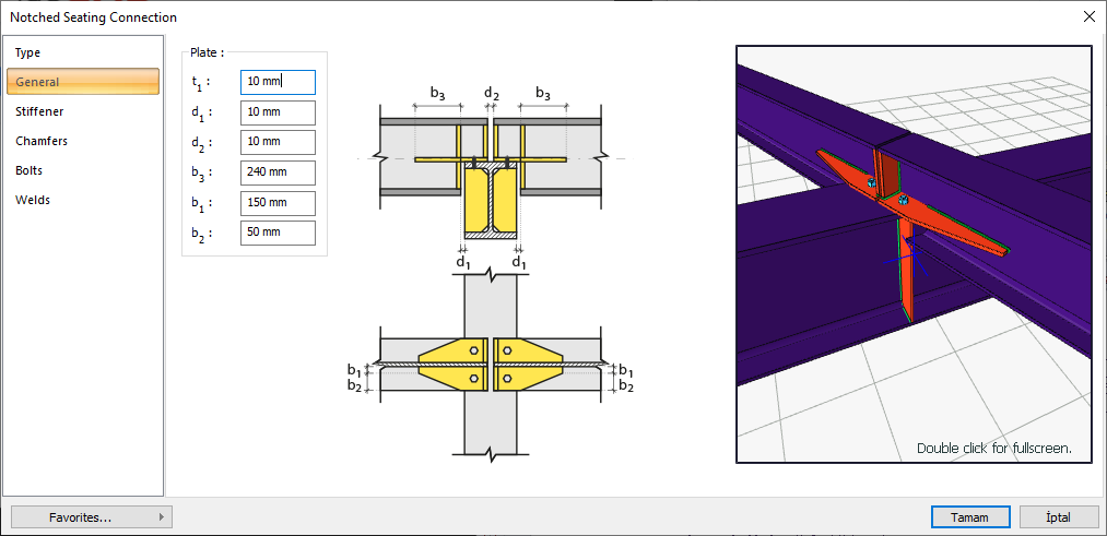

Plate

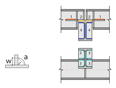

Plate dimensions are determined by entering values. The values ​​to be entered are shown in the schematic drawing.

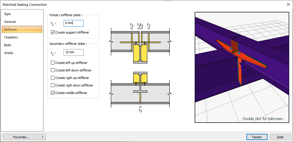

Stiffener Tab
Primary stiffener plate
The main primary stiffener plate is determined by entering the value. The values ​​to be entered are shown in the schematic drawing.
Secondary stiffener plate
The secondary stiffener plates are determined by entering the values. The values ​​to be entered are shown in the schematic drawing.

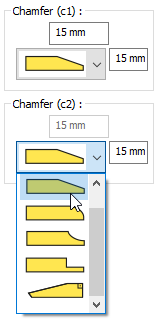

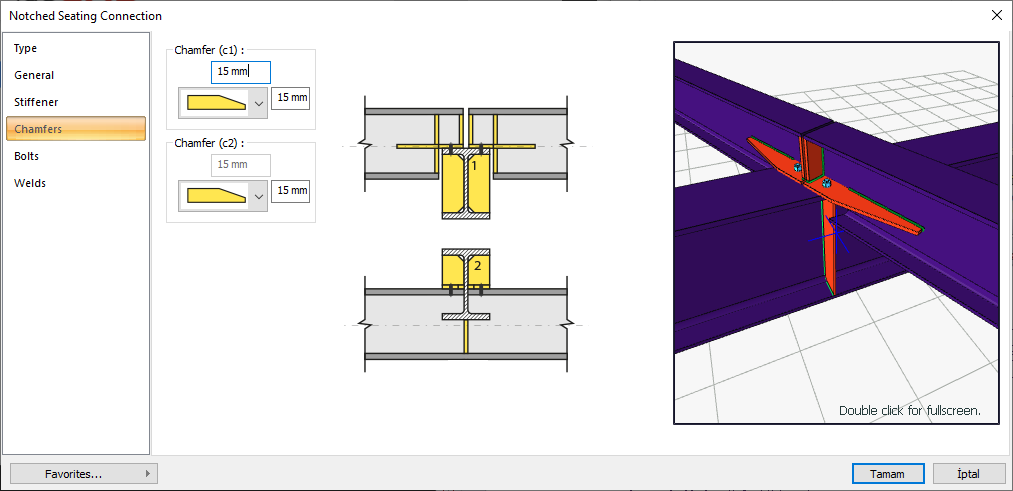

Chamfers Tab
Chamfer (c1, c2)

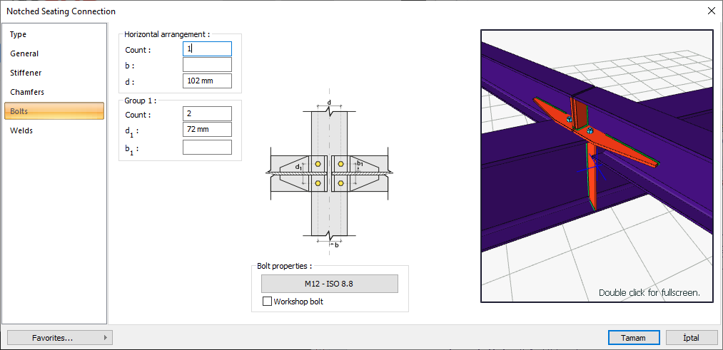

Bolts Tab
Horizontal arrangement
Group 1
Bolt properties

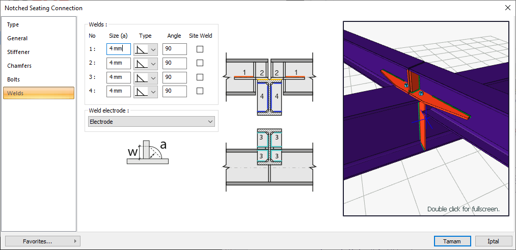

Welds Tab
Welds
The thickness, type and angle values ​​of the welds to be made at the joints are given. The information on whether it will be done on the construction site or not is entered.
Weld electrode
